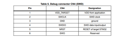

ST link is being powered with USB cable , iam using Nucleo board so it is with 3.3V from usb itself
see cn4 :
pin 1 has to get 3v3 .
