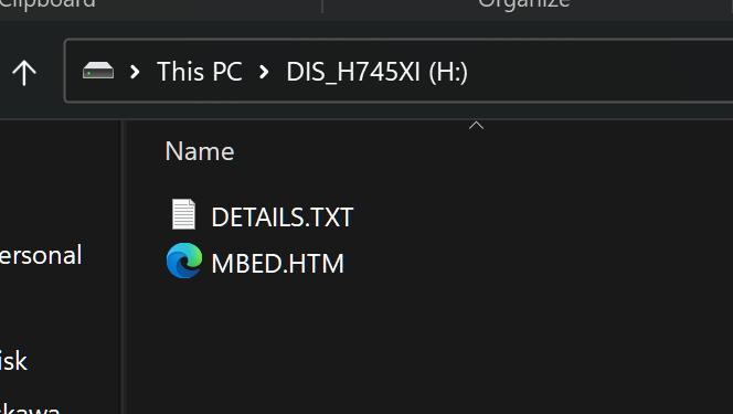

However, the device is seen as an USB disk.

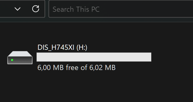

0693W00000WLLiJQAX.png0693W00000WLLiOQAX.pngThe problem is - the HEX file is too big to fit in there. Is there a workaround for it?
I tried to generate a BIN file, but it's 2GB - why? My whole project doesn't use that much data.

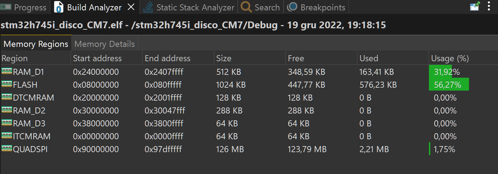

Here:
0693W00000WLLinQAH.pngI need to send the update to someone that has the device, but no ST software installed. What are the options?

>>Why is BIN 2GB?
Because binary files can't be sparse (ie containing large voids), and describe memory at 0x08000000 up through 0x90000000, which is around half the 32-bit 4GB address space.
You'd need to break it into pieces, some of the better tools will do that.
Still the QSPI space is bigger than 4MB, and not supported by the ROM boot loader. It supporting the eMMC would surprise me.
You want to push something in, you're going to have to make a target side USB-DFU loader, that's aware of the QSPI memory, they pins and the type/size of device.
You could perhaps make a USB-MSC loader that's got awareness about .HEX or .ELF files.
Or you could use the ST-LINK/VCP and make a loader on the UART that can do X-MODEM from a terminal application.

OMG, I missed your answer earlier, QSPI data is labelled as FlashExt by TouchGFX and I think it doesn't always require updating. Correct me if I'm wrong, but I believe it the TouchGFX uses QSPI memory to store its assets, so if the assets are not changed, I don't need to update that part of memory. So now - how can I remove the QSPI part from the HEX file? The hex file is generated by linker built in STM32CubeIDE. It's generated using the linker script that is also generated by STM32CubeIDE.
Likely spit out via OBJCOPY in this instant.
I'd kind of expect the .HEX to be relatively linear, so you should be able to find the record describing the 0x90000000 basis, it will be a shorter record, as the blocks of data span 64KB in most cases.
You should be able to cut the data with an editor/script, leaving the closing records. The patterns should be easy to match.
OBJCOPY or SRECORD should be able to narrow things down, not tools I use day-to-day.
