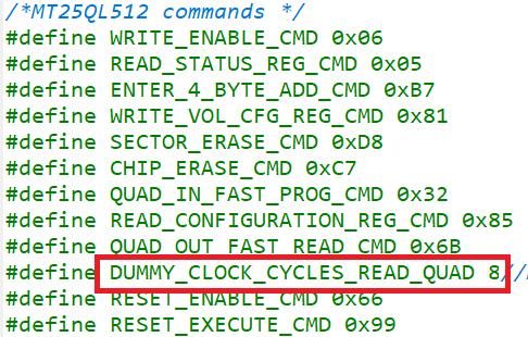

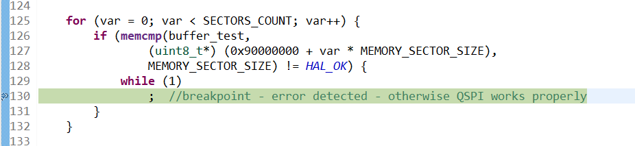

I use STM32H750B-DK to do external loader function.
"H750_External_Loader.zip" is my test code.
On below have error happen, I got error while memcmp
That's the code that I've used as my base:
https://github.com/WellinZHANG/External_Loader

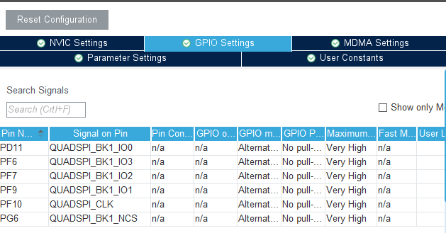

QSPI Setting
YCF.1
This issue had to solve.
The code had some error, must change code like below.

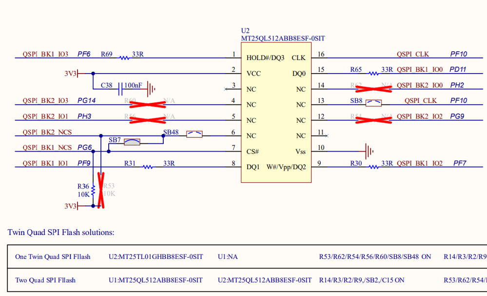

Please double check if you're not in the case of the errata "2.4.4 Memory-mapped read of last memory byte fails". If yes, please configure FSIZE the double size of the real size of your memory.

The issue may be memory ​mapped fail, because I try to
memcmp(buffer_test,(uint8_t*) (0x90000000 + var * MEMORY_SECTOR_SIZE),1) still fail.
The memory mapping needs to be working
https://github.com/WellinZHANG/External_Loader/blob/main/QSPI%20testing/main_test.c#L36
If it's already failing at the first byte then perhaps the command/template is wrong.
Check dummy cycles, command format, etc.
On the H7 there's an issue at the end of memory, about 32-bytes / cache-line that has an errata issue, but you'd need to be using the whole memory.
