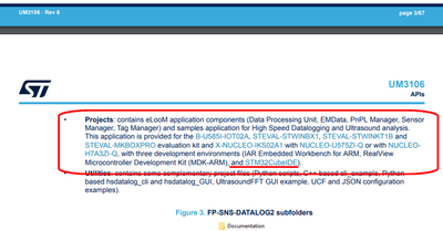

Andrew Neil
User Manual UM3106Getting started with the STM32Cube function pack for high speed datalogging and ultrasound processing
https://www.st.com/resource/en/user_manual/um3106-getting-started-with-the-stm32cube-function-pack-for-high-speed-datalogging-and-ultrasound-processing-stmicroelectronics.pdf
via:
https://www.st.com/en/embedded-software/fp-sns-datalog2.html#documentation

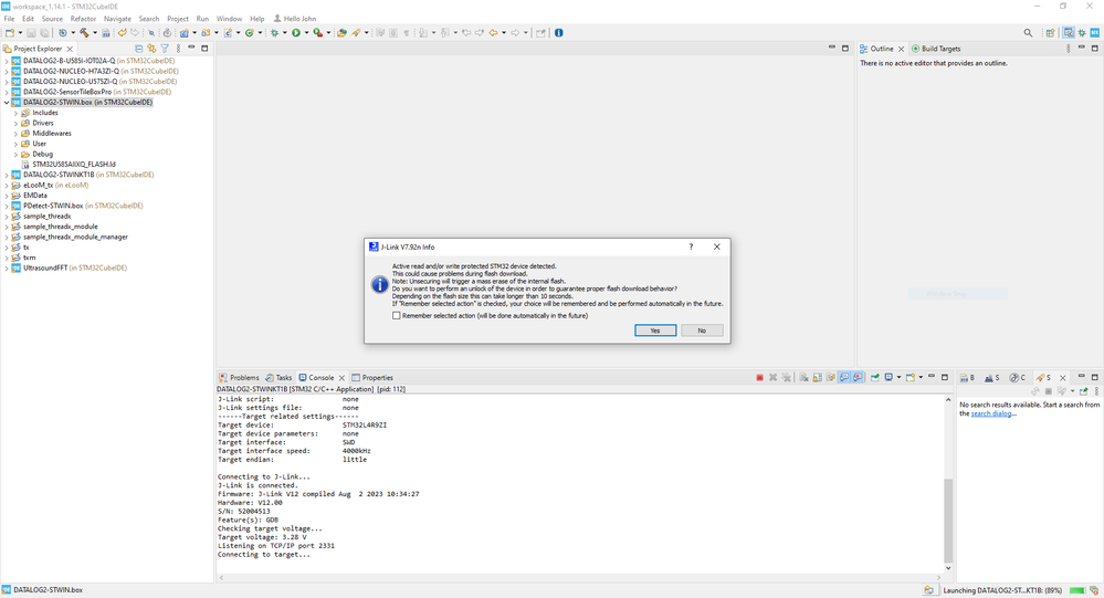

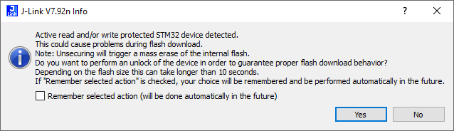

I am using a Segger J-Link Base to try and flash/debug the DATALOG2-STWIN.box application, but get the following warning...

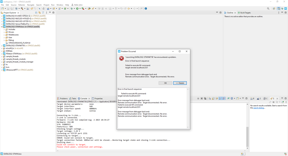

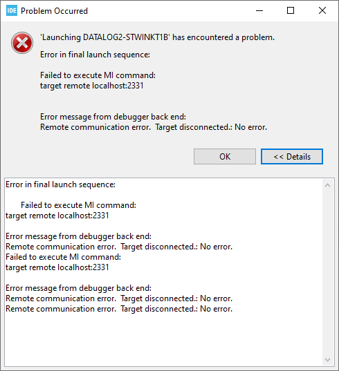

If I select yes (multiple times) I then get the following error...
Seem to have fixed it, there was no power to the board (even though the battery was connected) so I powered the board via the USB connector
