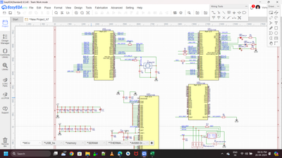

Hi , As i decided to use h743 lqfp 208 for my application(ECG MACHINE WITH DISPLAY 1080*800-8.88") use of
- ETHERNET
- FMC for SDRAM
- QUADSPI
- SDMMC1
- USB OTG FS
- LTDC
- UART, I2C and SPI
is avoiding that h745or747 dual core is ok? 743 is itself enough right?.or is dual core usage is complicated?

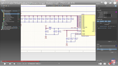

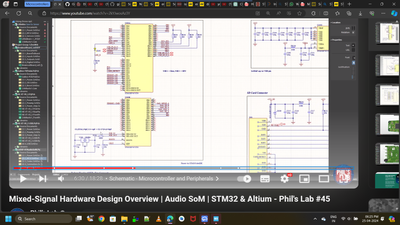

As I'm new to PCB design, I initially followed a video for the STM32H723 MCU in an LQFP144 package. However, I later realized that the GPIOs would not be sufficient for my project. Consequently, I found another video featuring the STM32H743 VIT6 in an LQFP100 package, and I decided to replace all the pins from the H723 with those from an H743 in an LQFP208 package. I have some doubts about this approach. Is it correct to swap the GPIOs and make slight corrections to the crystal circuit, VSS, and VDDs by referring to the schematics for the H743 with 100 pins? Or should I follow the reference schematics for the STM32H743 Discovery board, or can I simply follow the video for the H743 in an LQFP100 package?"
Mixed-Signal Hardware Design Overview | Audio SoM | STM32 & Altium - Phil's Lab #45 (youtube.com)
 Mini 6-Layer Mixed-Signal Hardware Design Walkthrough - Phil's Lab #78 (youtube.com)

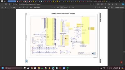

Thank you for your kind reply. Yes, my role is solely to select the chip and design the schematics, while a senior colleague handles the PCB design. However, he is not familiar with the STM32. Another colleague and I are involved in developing our company's own product using STM32. We have successfully demonstrated this using the F769-DISCO board, and now I need to use an 8.88" display with at least a 1080x800 resolution, so I decided on the H7. Unfortunately, I initially learned schematics from a dedicated H743 100-pin video. As I require SDRAM, LTDC, and eMMC, this would occupy many pins, so I switched to the STM32H743 in a 208 LQFP package instead of the previous one.
As you mentioned, I found a reference schematic for the H753 in the hardware application note. If I follow this reference schematic exactly, will my MCU function properly? Regarding the selection of active components, which should I prioritize? The STM32H753 eval board contains complicated and obsolete parts. What steps should I take after following the basic schematics provided in the reference?
 this is partially followed by ref..

‎2024-04-26 10:17 AM - edited ‎2024-04-26 10:17 AM
so I switched to the STM32H743 in a 208 LQFP package instead of the previous one.As you mentioned, I found a reference schematic for the H753 in the hardware application note. If I follow this reference schematic exactly, will my MCU function properly?
The answer is yes.. You need to add more decoupling capacitors for the "extra" VDD pins (vs LQFP144 package).
