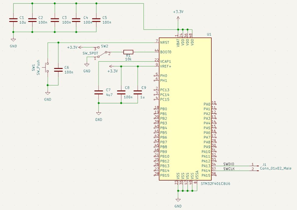

> Put a 4-pin connector for programming/debug: Vdd, SWDIO, SWCLK and GND.
I would add NRST, too.
I would also think about the role of VDD - it may be a power connection, or it may be just so that the STLink can measure the target's VDD (which influences programming algorithm at low voltages, or with the galvanic-decoupled STLink it provides the required output level), or it may be unwanted (if both STLink and the target connects this pin to their respective power rails while both being powered from a different source).
You may want to put signals on this connector in a particular order, eg. as they are on the Nucleo board. Even if you want to put them to some other order, it's a good idea to place GND in between SWDIO and SWCLK, so that it shields one from the other if a flat cable is used.
Don't use long cables, 15 cm should be mostly it.
But if you don't intend to build a PCB, just use the breadboard, these remarks are not that important.
OTOH, I hate solderless breadboards and recommend you to avoid them.
> Pull BOOT1 low with 100k.
BOOT1 = PB2, see datasheet.
As long as you don't intend to use the bootloader, just ground BOOT0 and you can forget about BOOT1.

The part has a Data Sheet, would help to read it, or at least skim the power and connectivity portions.
Expect to connect ALL power pins appropriately,ie VSS's to ground VDD/VBAT to 3.3V. The VDDA runs the PLL and power-on-reset regardless of you're using ADC, DAC, etc
VCAP pins need capacitors, either one 4u7 or two 2u2 depending on IC. Should see around 1.25V on this if chip is viable.
Don't need crystals or clocks, part starts running from internal oscillator.
NRST should have an internal pull-up. Should see 3.3V if viable.

For 'F4xx hardware design, read AN4488. Don't forget about BOOTx pins.

Schematics attached.
I read the datasheet a few times as some of you advised, and I came up with a minimalistic circuit.
Again, I just want to power on the naked MCU I have, boot it, and load a simple program via SWDIO/SWCLK pins. I made schematics on KiCAD for this. I'm doing this on a breadboard (I know, some might say it will not work, but I asked ST support, and they told me that if I make my connections ‘solid’, they don’t see a reason why it wouldn’t work)
There is something I don't understand, the datasheet seems to indicate that I need to connect the VREF+ somewhere, I think I understand that I should connect it to VDDA which in my UFQFPN-48 package I don't have as a separate pin (the datasheet on page 33/139 says that the pin 9 is VDDA/VREF+ and it says that pin 8 is VSSA/VREF- so I'm more confused now, looks like VREF+ and VDDA are the same pins, and after reading 'power supply scheme' on page 56/139, I decided to wire VREF+ to VDD, in a similar way as the rest of VDD and VBAT, with decoupling capacitors.
I also read the AN4448 (hardware development for STM32F4xxxx) and it says on pages 25/50 and 26/50, that the boot modes are selected by the state of BOOT0 and BOOT1, but I don't have BOOT1 (actually I couldn't find BOOT1 in any package for this MCU)
So, right now, I'm not sure if I'm wiring VREF+ correctly, and I'm not sure how to select each of the three boots modes with only BOOT0
My schematic is here, if anyone cares to review it and critique it, that would be nice.
