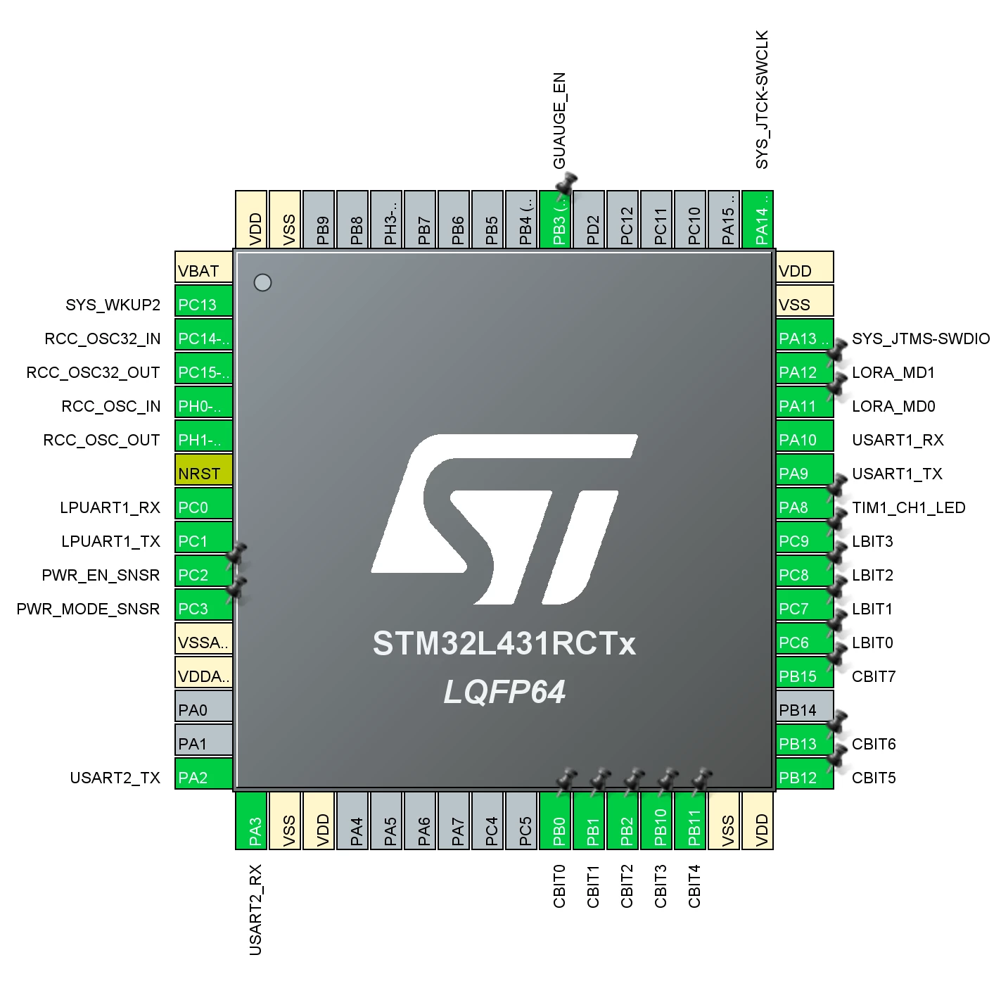

Hi, I am developing a low power application using STM32L431RCTx of 64-pin QFTP package.

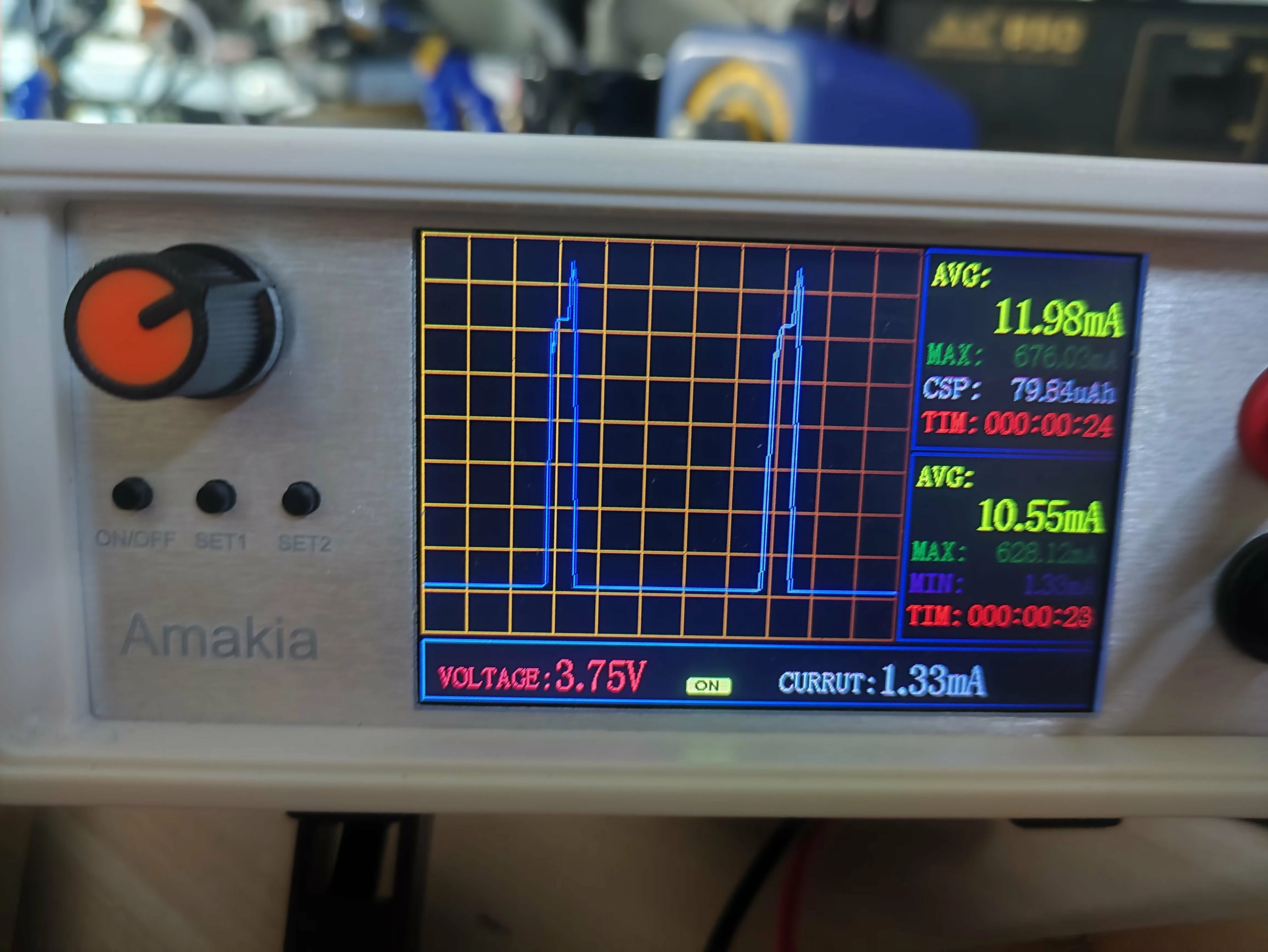

I have gone through the manual and some web content and tried several methods. The minimum current consumption I could achieve is 1.33mA at 3.6V power supply.

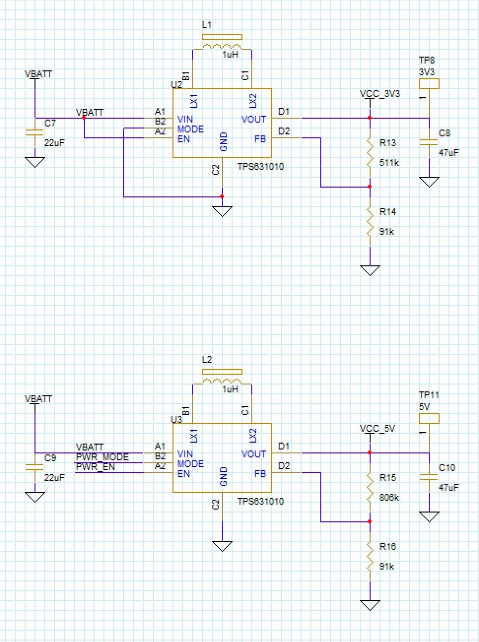

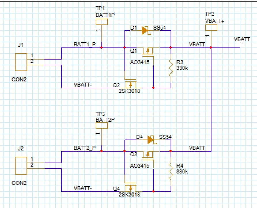

The system uses two ER34615 batteries in parallel for power supply. I have two TPS631010 chips working at 3.3V for the MCU and RF, 5V for the sensor circuit respectively.
The MCU uses 8MHz and 32.768k as external HSI and LSI clock respectively. The MCU works at 2MHz.
Here is the CubeMX configuration.
The code for entering standby mode:

The possible looping circuit that might consume power:
The battery block
The 3.3V and 5V block

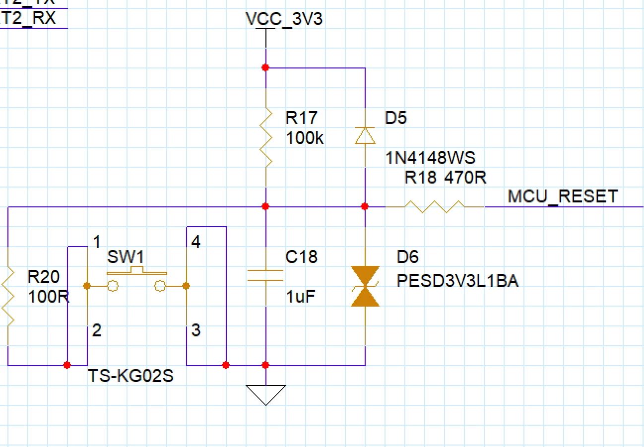

The MCU reset circuit

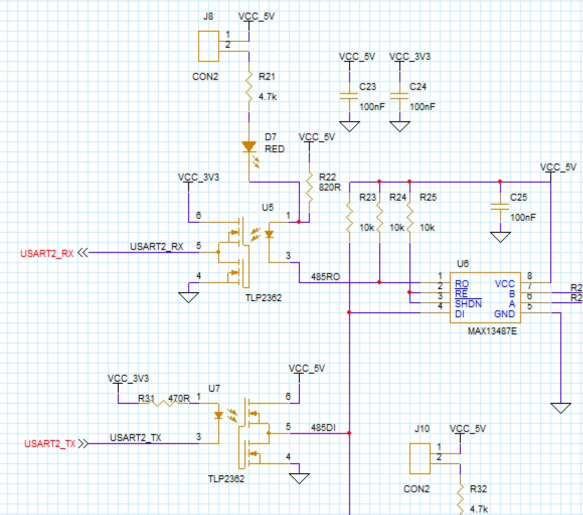

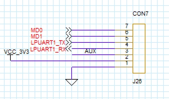

The 485 transceiver circuit. The 5V is turned on only at the time of reading sensors.

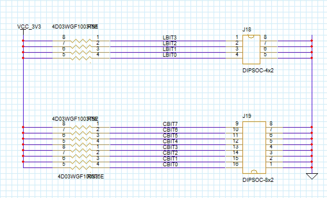

We also use some DIP switches to set up the address of the device.

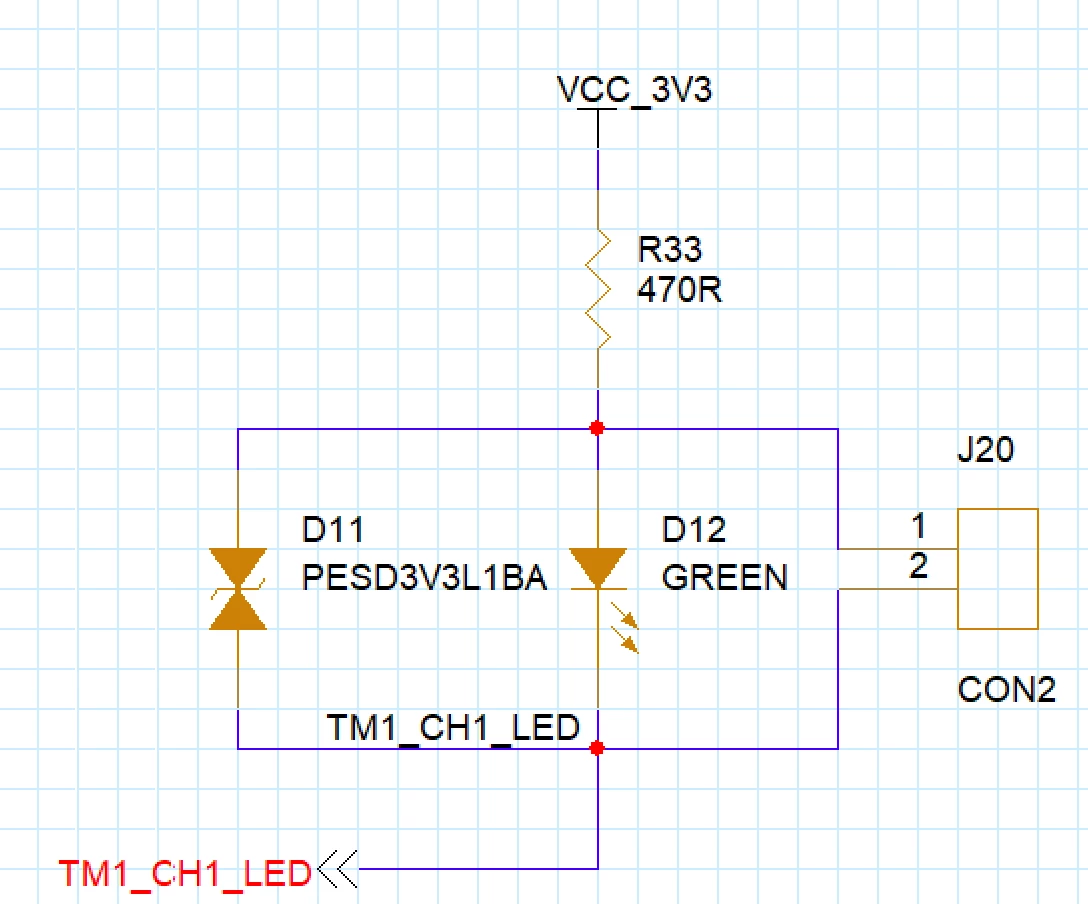

The LED circuit with PWM as indicator.

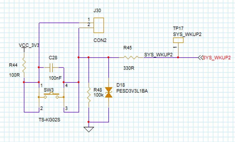

The WAKUP circuit with a button key.

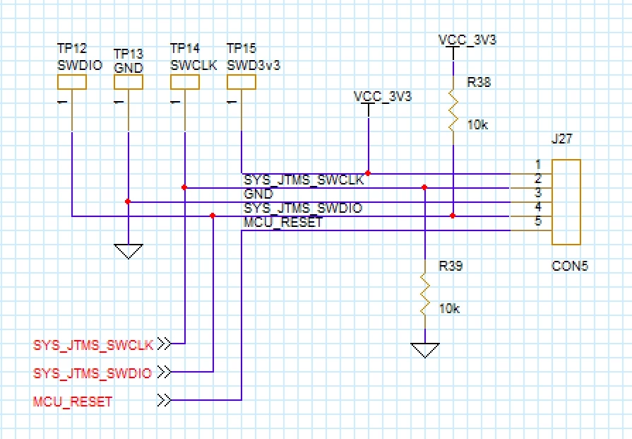

SWD circuit for downloading code to the MCU.
The RF module works at 3.3V. It has a low power mode and works good. The system consumes 1.33mA with or without the RF module.
Before going to sleep, I have down the following. Honestly, it seems the code does not work or I am not doing it right. The current consumption stays the same after adding these de-init code.

Make sure the low power modes' debug options are off. The debug module and some internal clocks can remain active during low-power modes, you can disable these options by clearing the debug bits in the DBG_CR register, check this article: Increased consumption in low power modes - STMicroelectronics Community
Andrew Neil
March 3, 2025
+1
@NEdom.1 also ensure that the debugger is physically disconnected - otherwise you will get leakage into the connection.
NEdom.1
NEdom.1Author
March 6, 2025
YES. I have already disconnected the SWD debug pins. Thank you for reminding.
