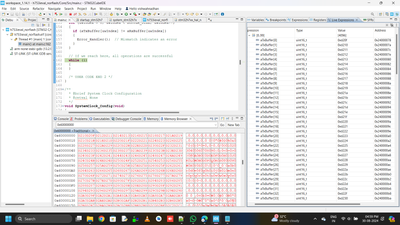

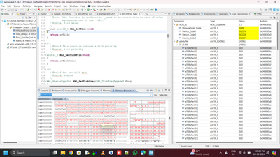

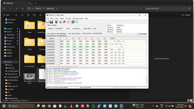

HI,
For testing and debugging FMC_norflash(MT28EW01aba) with custom h753 board, I used h743i-eval example as it is for read,write,erase, hence, i could read Manufactring code in memory browser, but in live expression i see address is different, so, where should i check for proper tx and rx data to be match.
