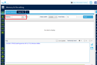

Hi, what is the difference between .elf file and .bin file to program STM32. If I load up the .bin file and program STM32, will it contain all the necessary such as program data and flash data. Is there a application to program individually the .bin file separately apart from STM32CUBE IDE.

You can do it with STM32CubeProgrammer but you need to put the first address of the flash as .bin file does not contain the addresses like HEX file.

No this is an old and depricated tool called STLINK-Utility.
This is the link to STM32CubeProgrammer: https://www.st.com/en/development-tools/stm32cubeprog.html
