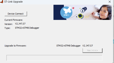

sonleducAuthor
March 22, 2026
It can be detected by stsw-link007-v3-17-10

> flash the firmware successfully using STM32CubeProgrammer, but debugging through STM32CubeIDE fails with the error above
Sounds like you are using a counterfeit programmer and/or board. This is typical behavior. A genuine board will work.

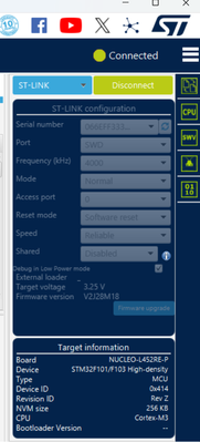

sonleducAuthor
March 22, 2026
Hi TDK, I trying to use ST-link from board nucleo but it still not work on IDE.
Andrew Neil
Andrew NeilBest answer
March 23, 2026
(emphasis added)
@sonleduc  But if you've still using a fake STM32 as your target, then this is still expected behaviour - as @TDK said.
As the name suggests, STM32CubeIDE is provided for working with genuine STM32 chips - it is not supported for 3rd-party fakes/clones.
See this thread.
sonleducAuthor
March 22, 2026
Here is an issue as in the picture
