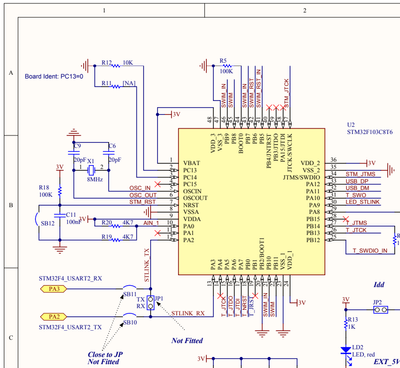

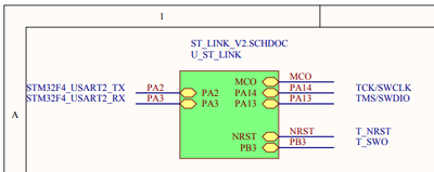

Indeed the User Manual makes no reference to a VCP
https://www.st.com/en/evaluation-tools/32f411ediscovery.html#documentation
Although the schematic does show UART connections to the ST-Link:
https://www.st.com/en/evaluation-tools/32f411ediscovery.html#cad-resources

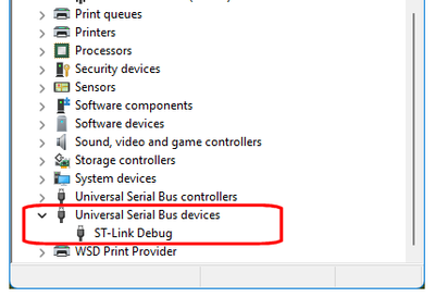

@gammmmmm does the ST-Link show as a debugger in your Device Manager?
See: https://community.st.com/t5/stm32-mcus/how-to-solve-debugger-connection-issues/tac-p/698105/highlight/true#M956 for troubleshooting tips
mƎALLEm
Are you sure you are using a data cable and not a charging cable?
If you try to connect with STM32CubeProgrammer, are you able to connect to the MCU?

That STM32F411 board looks to be similar to the STM32F4DISCOVERY.
The STM32F4DISCOVERY's on board ST-Link doesn't incorporate a VCP. I would take a guess to say the STM32F411 doesn't either.

The Original STM32F4-DISCO lacked mbed and the VCP/MSC, smaller STM32F103
Later mbed was adopted, and a newer/larger STM32F103 was employed
The STM32F4-DISC1 iteration escaped the ST-LINK/V2-1 VCP to pins, but did not change the circuit to get them to the STM32F407
The NUCLEO-F4 boards DON'T have this issue because they came out to support mbed.
But the NUCLEO-64 boards typically shared the VCP UART and ARDUINO D0/D1 pins

Hey, it appears as STM32 STlink
