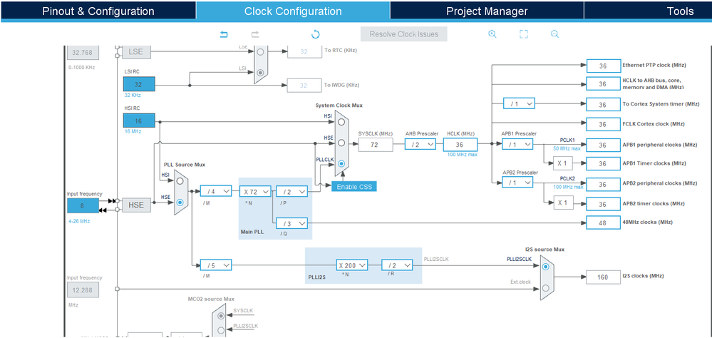

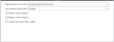

I see that my code hanging at  SystemClock_Config(); So i changed the settings according to the images below
But the same issue still occurred
So you've configured it to use an external crystal.
Does your Discovery board actually have an external crystal?

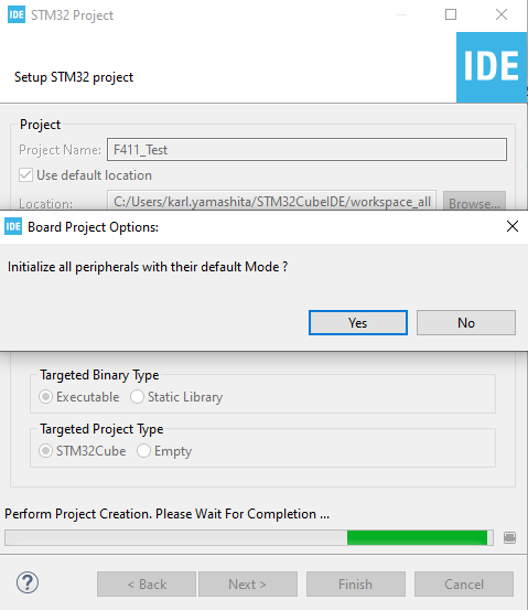

Did you start with a new Board project?

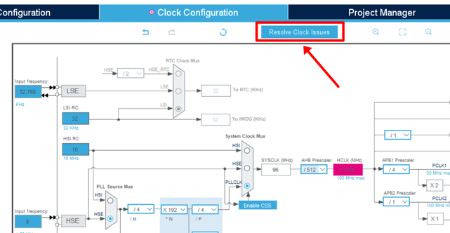

If you do, you have the option for STM32CubeIDE to configure the peripherals for you, including the clock.
If you ever mess up the clock configuration, you can always get STM32CubeIDE to resolve the clock issue to a working state. Then you can custom configure the peripherals clocks again.

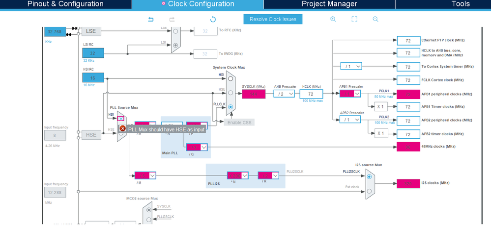

- In the previous response, I meant that I couldn’t select HSI because the IDE said: "PLL mux should have HSE as input."
- I found other posts related to the problem, and I realized that I only needed to disable USB_OTG_FS. After that, I successfully blinked the LED regardless of using HSE or HSI.
But in the future, if I need to use USB_OTG_FS, what should I do? What exactly caused the issue?

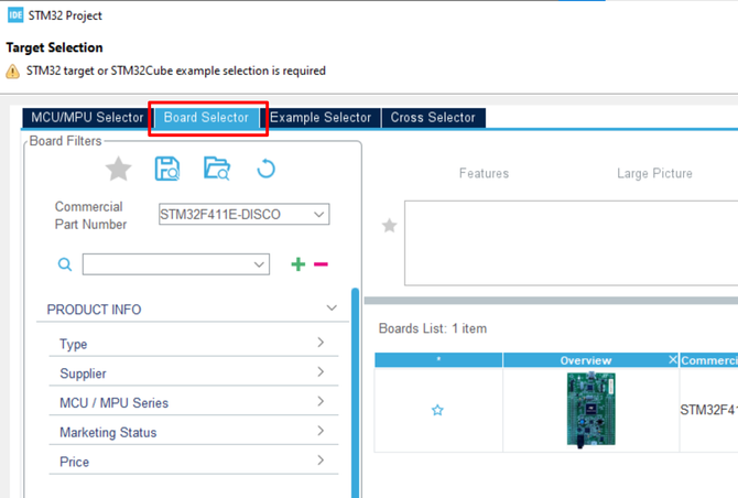

Again, did you configure the board using the Board Selector?
