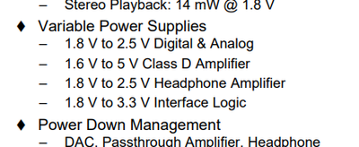

As already explained, the STM32f469  does not have any audio CODEC integrated.
The audio CODEC on the STM32f469-Disco board is external to the STM32f469 chip

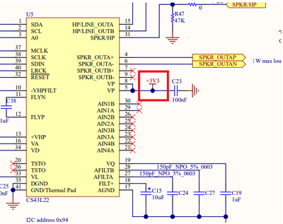

The voltage indicated is the power supply of the PWM output stage of the codec.
You need to read the datasheet of the Codec:
The power supply of the codec is 3.3V for this disco board:

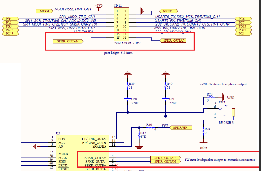

See the schematic posted by @mƎALLEm earlier - it shows you that CN12 pins 15 & 16 are directly connected to the Cirrus logic SPKR_OUTA+ and SPKR_OUTA- output pins:
so these are solely a function of the Cirrus logic chip - nothing to do with the Disco board or STM32 microcontroller.

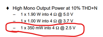

Sorry I have not framed the sentence properly, but yeah I didnt mention as in the IC there, I was meaning the STM32 development board had an audio codec, so yeah that wasnt my doubt, my doubt was that since the audio codec is being controlled by the STM32f469 chip, I was wondering what would be the voltage output peak and rms at those 2 pins so that I can accordingly choose an impedance for the speaker.
Hope my question is clear to you now.

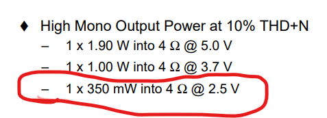

I mean that I understood so only I have asked since the PWM of cirrus logic is powered by 3V3, I should then  consider only 2.5V as 3V3/1.414 is roughly 2.3V rms..so while choosing a 4 ohm speaker I have to choose a speaker that is rated say 0.5W then the speaker will be safely driven.
Have I understood it correctly now or am I still messing this up(sorry if I am, please help me)
