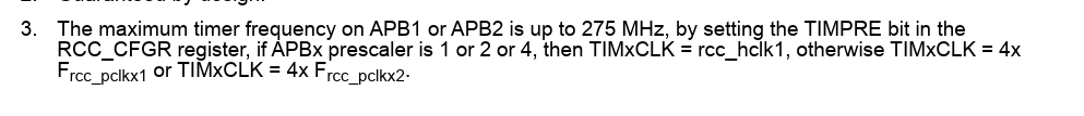

I am trying to achieve the maximum timer clock on the STM32H723ZG for input capturing. In the data sheet is written under Table 4: "The maximum timer clock is up to 550 MHz depending on theTIMPRE bit in the RCC_CFGR register and D2PRE1/2 bits in RCC_D2CFGR register."
I tried to achieve this in the Clock Configuration but it seems like the only solution I found is invalid (see screenshot below). Can I still do that? Or is there another way to do that?

Red = wrong !
set HPRE div 2 , then get max. clk on APB1 timer clk.
try.
I tried, HPRE /2,  D2PRE1 /2 (137.5 MHz is max for APB1 Peripheral) and then APB1 Timer is 275 MHz. In the data sheet it is written, that 550 MHz should be possible, but I cannot find a way?

in my ds H723 :
where is 550MHz written ?
Hello @icethi
As indicated on the table, 4 of the datasheet, the maximum timers clock is 275MHz. But the Systick timer clock is up to 550MHz. The answer of this post may help you.

But the systick clock is different from the timer clock, right? According to the data sheet the timer clock should have 550 MHz.

See it as marketing gag : there is one timer, sys , that can run on core clk , 550M . All other NOT .
Except you set the D2PRE1 yourself ... overclocking . The timer should work at 550M...but what else works, or not, you have to test yourself.
