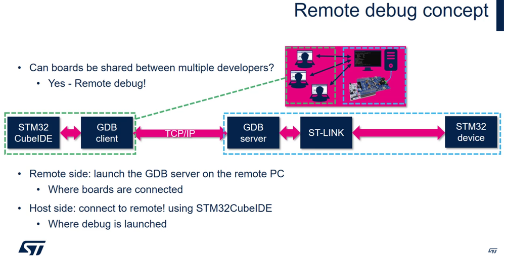

This is the recommended way to do remote debugging:
https://www.youtube.com/watch?v=Xw5ojR2Ygcw

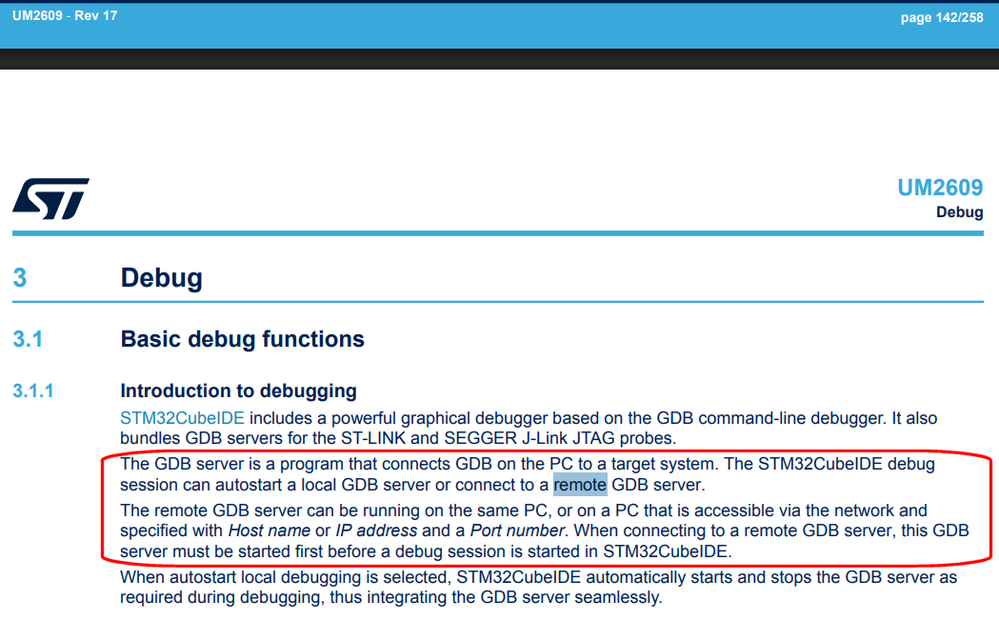

See also:
https://www.st.com/resource/en/user_manual/um2609-stm32cubeide-user-guide-stmicroelectronics.pdf#page=143

lakins
What would be the proper way to do it with openocd?
GDB Server will be running on Windows machine, and client will be connecting to flash/debug from Ubuntu.
Just to note environment is VSCode/CMake.
Looks like OpenOCD works the same:
https://openocd.org/doc/html/GDB-and-OpenOCD.html
https://linuxjedi.co.uk/remote-programming-and-debugging-stm32s/
