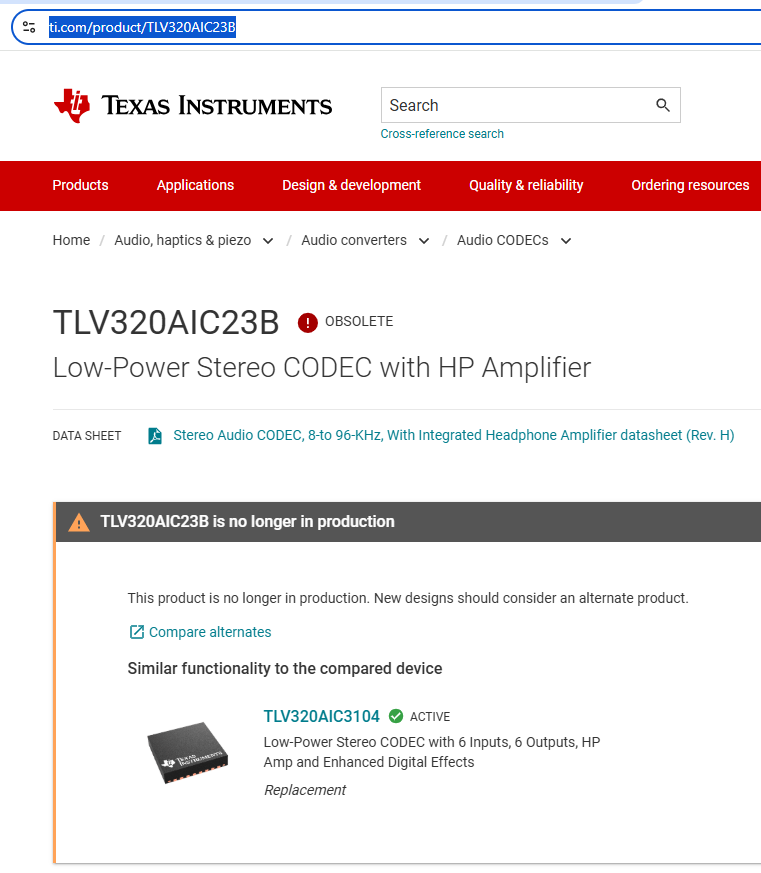

That would be governed by the TLV320AIC23B, which is a TI product - nothing to do with ST.
So you'd need to ask TI that question:
https://www.ti.com/product/TLV320AIC23B
And, as @LCE said, the TLV320AIC23B is obsolete - and no longer in production:

The only limitation of the typical STM32 SAI that comes to my mind is the fixed oversampling ratio (only 256 or 512), but check the H7B datasheet to be sure.
Anyway, the TLV320AIC23B is obsolete / end of life - are you sure you want to use that one?

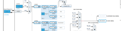

1. yes, using I2C and SAI in I2S mode will work fine.
2. yes, read ds TLV320AIC3204 ; depends on what you want use as Mclk ; typical is fs x 256 ,
so just use CubeMX , set clock tree and SAI to desired fs , check if its possible to get the fs x256 as Mclk .
ed
with clock at 98.33 M , you will be close:
cpu HSE can be 8 or 16 M , for example.
