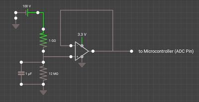

Hello everyone,
I'm working on a circuit for monitoring the bias voltage of a GM tube, which requires a high voltage of 100V. I am currently using a OA1NP22C op-amp configured as a unity-gain buffer to read the divided voltage. To minimize current consumption, I'm considering using a voltage divider with 1GΩ and 12MΩ resistors. However, this configuration still consumes approximately 9.8µA, which is higher than I would like for my low-power application.
Here is a simplified version of my circuit:
100V Bias Voltage (GM Tube)
R1 (1GΩ)
+----> To OA1NP22C Op-Amp (unity gain buffer) > MCU
R2 (12MΩ)
GND
My questions are:
  1. How can I further reduce the current consumption of this voltage divider to the nanoampere range?
  2. Would switching out the voltage divider using a transistor be a viable solution? If so, what configuration and components would you recommend for achieving this?
  3. Are there alternative methods or components that could help in significantly reducing the power consumption while maintaining accurate voltage monitoring?
Any insights, suggestions, or examples of similar implementations would be greatly appreciated!
Thank you!

Please check your idea again:
  • at 100V at 13Gohms a current of 7.7nA flows, not 9800nA
  • the OA1NP22C will surely be connected to GND, right? What voltage does it then see at his input? What happens then?
It would be better if you could insert schematics as a picture, including the opamp, so that we can make suggestions for improvement.

Hi Peter,
Thank you for your feedback. You are correct about the current calculations.
To clarify, R1 is 1GΩ and R2 is 12MΩ. Please find the schematic below for further reference.
Regards,
Zaim

AScha.3
You are there... 100V/1Gohm = 100nA . (100nA x 100V = 10uW - where you wanna go then ?
+ How much uA needs the cpu and all other circuit ? )

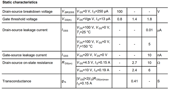

Yes. But to get lower than 100nA, you only could use a mosfet; but at your 3v3 supply, only few mosfets can work at >100V and be switched with < 3V at the gate - so close to impossible.

Hi AScha.3,
Thank you for your insights, I understand your points exactly. Finding a small MOSFET with a low gate voltage is indeed challenging. Therefore, I still think that the voltage divider solution may be the best for our product. I also realized that I miscalculated the current; it should be 89nA, not 9.8uA.
An important consideration for our product is cost, and as you may know, GΩ resistors are very expensive. Thus, the maximum resistance I can use is 1GΩ. So, the question is: are there any other ways to achieve lower current consumption for this circuit, or should we proceed with the current values?
As I mentioned earlier, I will enable the ADC for this feedback once a day. I was considering completely shutting down the circuit and only powering it when I need to read the values. However, if the switching circuit draws more than 100nA, it might be hard to used, and I might have to use the configuration with the 1GΩ / 12MΩ resistors.
Thank you for your support.
Regards,
Zaim
I mean 98nA with transistor off can be reduced only to DS leakage current for example BSS123N
and is temp sensitive. Primary reduce other corrents.
