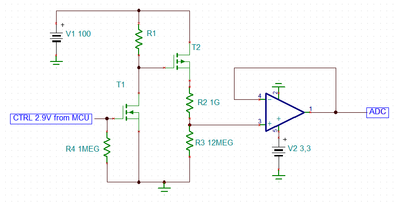

I'm working on a circuit for monitoring the bias voltage of a GM tube, which requires a high voltage of 100V. I am currently using a OA1NP22C op-amp configured as a unity-gain buffer to read the divided voltage. To minimize current consumption, I'm considering using a voltage divider with 1GΩ and 12MΩ resistors. However, this configuration still consumes approximately 9.8µA, which is higher than I would like for my low-power application.
Here is a simplified version of my circuit:
My questions are:
Any insights, suggestions, or examples of similar implementations would be greatly appreciated!
Thank you!
Feel free to ask for further details if needed.

i think, if you really need to measure the voltage, the 1GΩ / 12MΩ resistor is best, simple solution.
All photocouplers (AQVxx series) or mosfet at 100V have 100nA or more leakage current - so useless here.
Just - afaik - most ("professional" ) circuits anyway producing a regulated HV , so there is a point with some divider there, to check the voltage ; if you can access this, it would be the best solution, consuming no extra power.

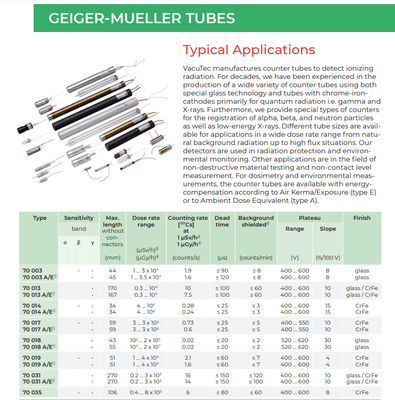

btw GM working at only 100V ? typical is 400...700V .

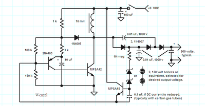

Regarding the GM tubes, you are correct; their working voltage plateau is typically from 350V to 2000V. In my design, the boost circuit initially steps up 3.3V to 100V, and from there, I use a 4-stage Cockcroft-Walton voltage multiplier to reach the required biasing voltage of 400V.
To minimize current consumption, instead of using a voltage divider at 400V, I take feedback from the input of the first stage of the multiplier, which is 100V. This approach reduces the power consumed by the divider resistors significantly.

2024-07-07 11:33 AM - edited 2024-07-07 11:34 AM
Would a N.O. Solid-State Relay (SSR) work in your application instead of a FET? (I've never used one, but it looks like a maybe)

@MM..1 Right, I had indeed read G instead of M for the second resistor, sorry.
@Zaim01 Once again on the subject of switching off the voltage divider: this only makes sense on the high-voltage side, as switching it off on the GND side shifts the measurement potential to 100V. However, in order to be able to switch off the voltage divider on the high-voltage side without having to use a charge pump with its current consumption, a p-FET would have to be used, which is controlled by an n-FET against GND. To ensure that the p-FET can also fully switch off, a gate-source resistor is required there, the current of which is added to the current through the voltage divider during the switch-on time. While the two FETs are switched off, the leakage current of the n-FET would be added to the leakage current of the p-FET.
It should also be noted that with such small currents, the circuit design has a significant influence on the results. For example, due to the possible board leakage currents, a conventional circuit board without insulation milling is poorly suited for this purpose.

2024-07-09 03:04 AM
You mean a circuit like the one below:
The issue with this circuit is the leakage of the MOSFET and the current consumption through R1. When increasing the value of R1, the P-MOSFET T1 may not turn off completely, and if R1 is too small, it could draw unnecessary current. Could you please recommend some values based on the schematic above?
Or, if I have misunderstood your point, please clarify.
