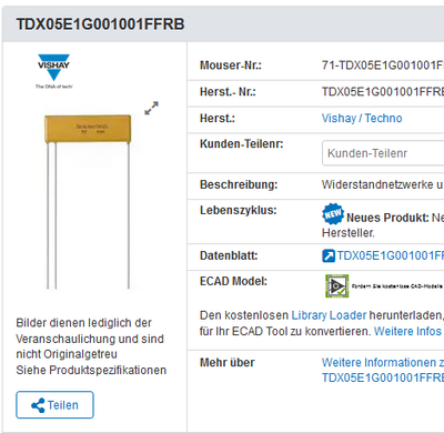

@Peter BENSCH , I still can't believe that using such a high resistance in a voltage divider is good practice. Is this really practical? any flux residue, dirt, oily fingerprint or anything really could substantially change the effective resistance of one leg of the divider and make the measurement inaccurate. Would you really expect this to work in a real-life product? even with a conformal coating (I'm assuming it was chosen with this in mind), this seems like a very precarious way to design circuits for the physical world (as opposed to spice). Am I wrong?
2024-07-09 4:24 AM
For HV this is "standard"...
here example: 1 Gohm

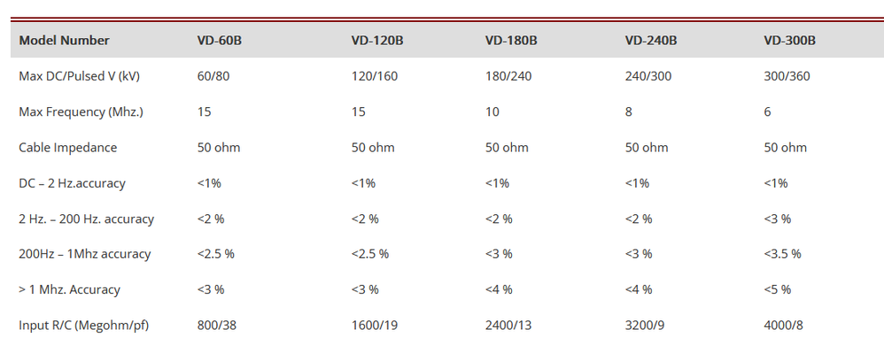

I believe such parts exist, but are they really meant for use as part of a measurement circuit? Do MRI machines, and Tokamaks really measure HV voltage this way? I imagine they use high-power resistors (or chain them in series), but not necessarily such high values.
2024-07-09 4:47 AM
Even the probes for scope are in Gohm range... (i have some here.) :)
-> 0.8 ... 4 Gohm.
These ARE for measuring...only drawback: cheapest is about 3000 $ .
2024-07-09 5:54 AM
@BarryWhit No, you are absolutely right. That's why I pointed out the problem of leakage current outside the voltage divider several times. Above say 100Mohms, every reason you mentioned becomes a problem. Nanoamperes always sound simple, but mastering them requires effort and experience.
2024-07-09 8:34 AM - edited 2024-07-09 8:48 AM
@AScha.3 wrote:Even the probes for scope are in Gohm range... (i have some here.) :)These ARE for measuring...only drawback: cheapest is about 3000 $ .
Very good point (But nothing the 600x difference in the working voltage of those specs vs. OP. And also wondering how often you're supposed to calibrate them). I wonder what engineering lengths they have to go through to maintain accuracy. Those probes must come in those fancy velvet cases, right? like a wedding ring. They probably don bunny suits and wash them with unicorn tears during final assembly ;)
