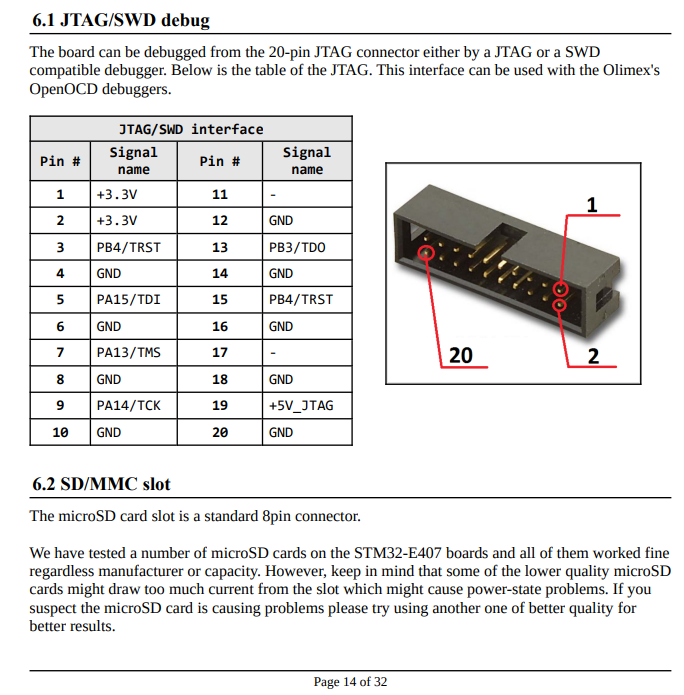

I am having a hard time figuring out working with the STM32-E407 which is built on STM32F407ZGT6 MCU. I also brought an ARM-USB-TINY-H as it was recommended in its documentation. How and where do I start ? Say I want to interface this board with a radar sensor.

As neither the STM32-E407 board nor the ARM-USB-TINY-H is an ST product, you should really be going to Olimex for support with their products:
support@olimex.com
https://www.olimex.com/forum/
You haven't said what tools you're using to program this board.
The ST tools are STM32CubeIDE and STM32CubeProgrammer - I think neither of them supports the ARM-USB-TINY-H.
I would suggest that you get an ST-Link; they are widely supported (unlike the ARM-USB-TINY-H) - and cheaper!
Just be sure to get a genuine one.

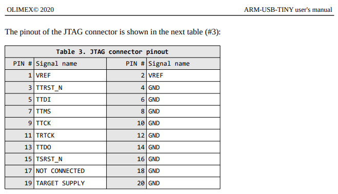

The board's debugger pinout is described in the User Manual:
https://www.olimex.com/Products/ARM/ST/STM32-E407/resources/STM32-E407.pdf#page=14
It matches the pinout of the ARM-USB-TINY-H - so you can just plug it in:
https://www.olimex.com/Products/ARM/JTAG/_resources/ARM-USB-TINY_and_TINY_H_manual.pdf#page=10
