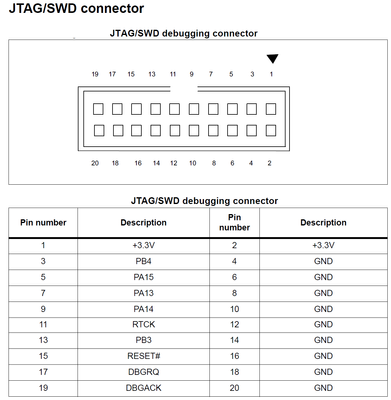

@MDe wrote:
I have an ST-Link cable. Is it possible to check what is running or not through debug ? If yes, how ?
ST-LINK cable or STLINK probe?
You need an STLINK probe and that "OLIMEX" board need to have an STLINK connector (Serial Wire Debug).

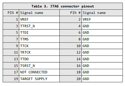

I have an ARM-USB-OCD-H device.
Here : https://www.olimex.com/Products/ARM/JTAG/ARM-USB-OCD-H/
I hope it's a probe ?
