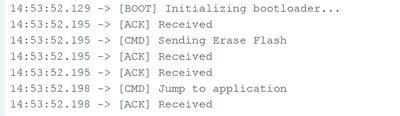

Hi @Tesla DeLorean ,
Now the Problem got updated , I am received the 0x79 back , the binary file only not get updated what may be the reason
You seem to have a communications problem.
You'll need to explain how you have this set up, and what exactly you're doing.
Log suggests you're doing an Erase and Go/Jump operation, but you've provided zero actual detail of your system or interactions with it.

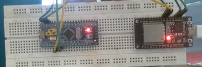

this was my hardware setup @Tesla DeLorean manually controlling the boot pin.
what my condition was i am initialized the bootloader receving the ack 0x79 for that , but the write operation and erase is not done. every time i checked with the cube programmer nothing is erased and written in new. this was my current condition
