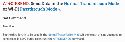

Certainly there are no issues with the STM32G0 sending UART data. The content is whatever you want it to be. Whether or not someone has done this particular application seems immaterial.
Documentation suggests AT+CIPSEND cannot send more than 8192 bytes.

Pretend it's not an image, and that it's just arbitrary binary data? Look for more general examples, perhaps GNSS NMEA data stream, or files.
Look at what AT+CIPSENDL permits in longer form, or perhaps come up with a protocol where you split the 20KB into smaller pieces that you reassemble at your Socket Listener

https://docs.espressif.com/projects/esp-at/en/latest/esp32/AT_Command_Set/TCP-IP_AT_Commands.html#cmd-send
