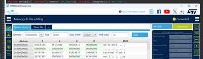

External loader built; CubeProgrammer can erase, program, verify and read the entire flash (see screenshot).
Constant data is programmed successfully:
const char string2[30] __attribute__((section(".ext_flash"))) __attribute__((aligned(4))) = "Hello Word";
CubeProgrammer shows the text correctly.

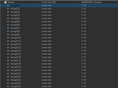

As soon as I switch to Memory‑Mapped mode every word read is 0x00000000.
No hard faults—just empty data.

With STM32CubeProgrammer and the external loader I could read the data:

The code I shared actually works fine. The issue turned out to be a faulty high‑side switch I was using to turn the flash on and off.
I haven’t analysed the root cause in detail yet, but it looks as though power consumption in memory‑mapped mode is higher than in normal read/write mode. Each time I called
HAL_StatusTypeDef OFlash_EnableMemoryMappedMode( void )
the flash’s VCC line sagged and the device performed an unwanted reset.
