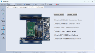

For some unexplainable (to me) reason, it looks like the board looks for sensors placed on another expansion board I don't have so that I am unable to get sensor data from the magnetometer placed on the IKS4A1.
The IKS4A1 magnetometer is placed on the right side of the board. I have not the green board shown in the picture and it seems to me I have not configured it.
When I open Unicleo the user message tab shows:
Port: COM8 Successfully Opened
PresString Received: MEMS shield demo,12,10.0.0,1.5.0,IKS4A1
Firmware Type: E-Compass
Expansion Board IKS4A1 Successfully Initialized
but nothing works.

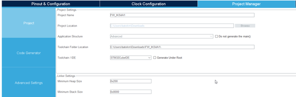

Here my Cube project.
Any help will be very appreciated.
Thank you.
Miroslav BATEK
Hello @MRaff.1,

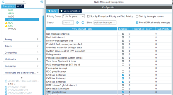

I have analyzed your .ioc file and you have to enable interrupt for TIM3.
I recommend you to increase stack size as well.
After that it works as expected.

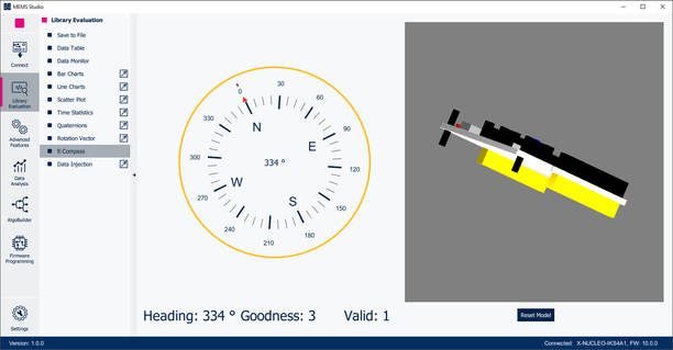

There is a bug in Unicleo-GUI which displays a DIL24 adapter even if it is not used, but this is only graphical issue, all the remaining functions work well. Anyway I would recommend you to use MEMS Studio which is our new tool.

Thank you Miroslav, set the TIM3 interrupt and increased the stack size, installed MEMS-Studio and now everything is fine. I am very happy. Thank you!!!!
