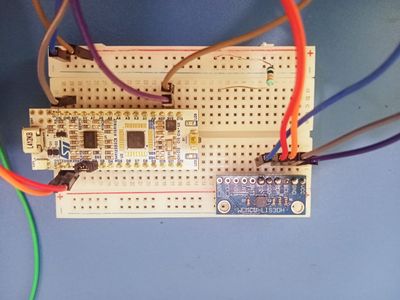

i am working on stm32l412kb with LIS3DH accelerometer sensor using stm32cubeide .
Kai_Satone
Senior
i am using i2c1 and uart2 to show any values i have created program but i am not getting any values from accelerometer. can you tell me any one, solution of this problem

Federica Bossi
Hi @Kai_Satone ,
Could you try to use our official PID examples and let me know if you get some results?
Thanks

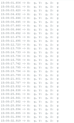

Andrew Neil
Please use this button to properly post source code:
Andrew Neil
@Kai_Satone wrote:
// Print accelerometer data to serial console
sprintf(buffer, "X: %.2f g, Y: %.2f g, Z: %.2f g\r\n", x_g, y_g, z_g);
Have you enabled support for floats in sprintf() et al ?
What happens if you just print the raw data bytes ?
I think yes, if floats are unable, this might trigger a warning at compilation.
Why do you use this syntax for the first params of accelerometer_read_data : 0x28 | 0x80?
