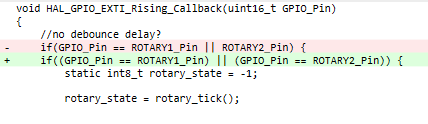

UPDATE:
Auch!, apparently the tilt interrupt pin number matched this wrong OR operation of other interrupt pins
Of all the pins you can choose as a designer!
Still wondering how Tilt pin 0x0020 validates as true for if(GPIO == 0x4000 || 0x2000)
Although this fixed the problem of handling interrupts correctly, it is still not generated bij the MEMS.
I only tested the interrupt pin manually
How can I setup the portrait/landscape threshold angle and rigger an interrupt?

you mean
or
 if((GPIO == 0x4000) || (GPIO == 0x2000)) ?
