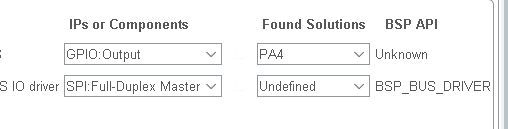

I'm trying to make first steps in ST32CubeIDE with some knowledge of C/C++. As a playground I want to communicate with Accelerometer in LSM6DSOX using driver described in document:
"DT0141 How to import STMems_Standard_C_drivers in an STM32CubeIDE project.pdf".
So, created new project.

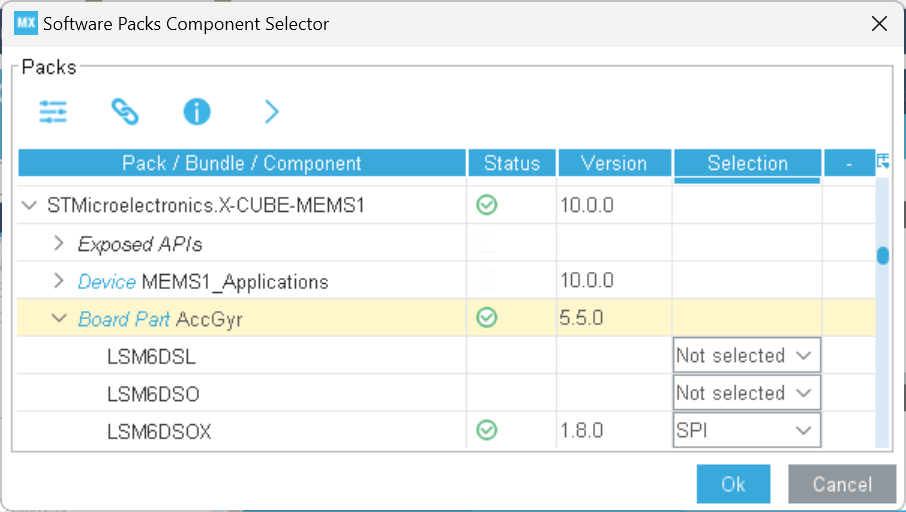

Added in Software Packs Component Selector an LSM6DSOX - SPI (v1.8.0):

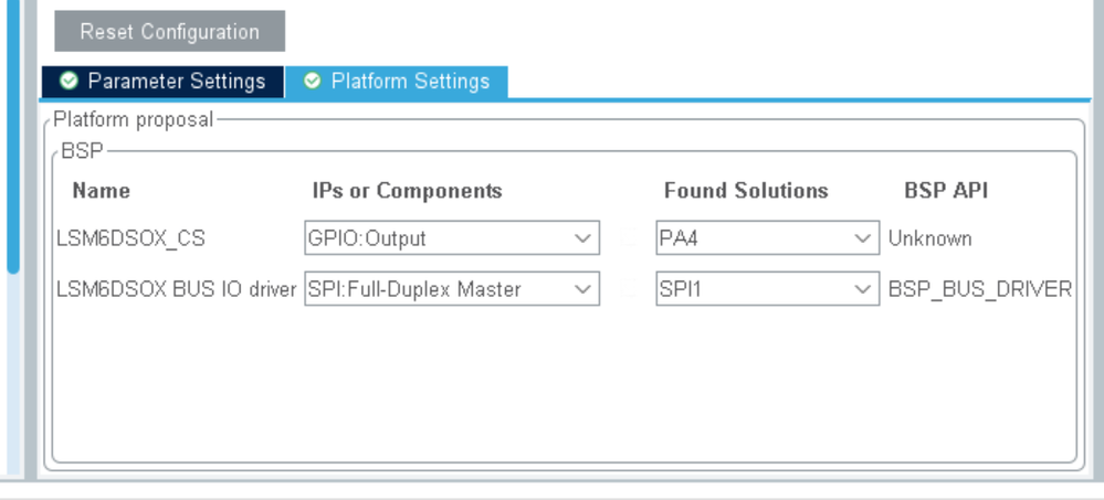

Configured SPI1 in mode Full-Duplex Master and X-CUBE-MEMS1:
When testing lines added to main.c I get an error from compiler in:
lsm6dsoxDriver.handle = &hspi1;
../Core/Src/main.c:110:32: error: 'hspi1' undeclared (first use in this function)
110 | lsm6dsoxDriver.handle = &hspi1;
There are more errors, but this one is first that I'm not able to fix
What am I missing? Maybe there is an error in PDF file.

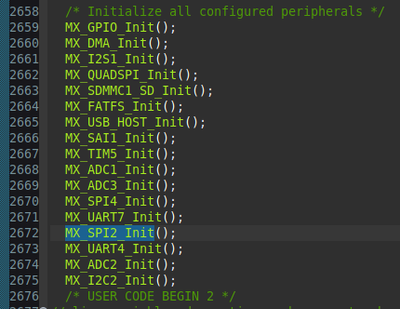

AScha.3

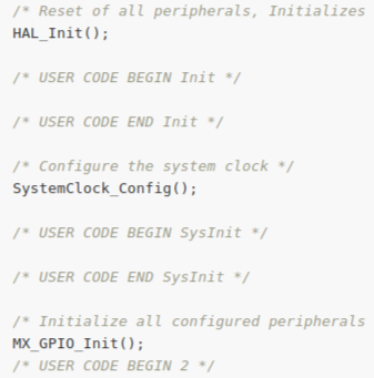

in your code i see no hspi init:
so : define spi in Cube -> generate code ! and compile again...hspi should be there then.

Nothing new appears in section you showed.
btw no need for "build all" ; just use the nice symbols : the gearwheel to gen.code, the hammer to compile. :)
see - all used units get a call for init:

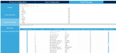

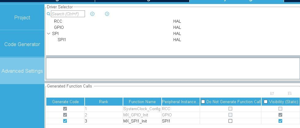

except you dont want it -- see in project manger -> advanced settings:
when you activate/use the spi - is the mx..init active and also no "do not ge. function call" set ?

Imie
Well..
If I leave undefined BSP_BUS_DRIVER
then SPI is visible in Advanced Settings:

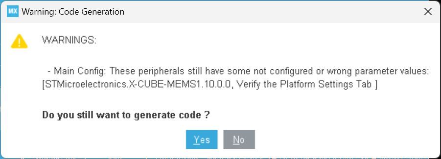

When gearwheel is pressed a Warning appears.

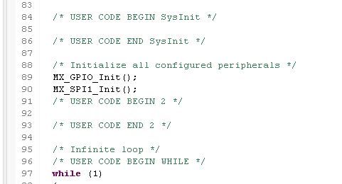

If Yes is pressed, code is generated:
I think I'll live with it :)
Thank You for these suggestions.
