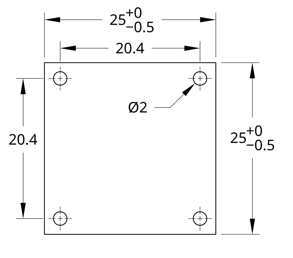

Hi @DPark.4​ ,
the X-Y dimensions of the industrial adapter STEVAL-MKI208V1K are 2.45x2.45cm.
You can check it by opening the gerber files available on the site under the Hardware Resources section, STEVAL-MKI208V1K GERBER.
You can open the files with your pcb design software or otherwise with a free online gerber viewer allowing planar measures.

Thank you for your reply. I opened the Gerber file through online Gerber viewer but I cannot check the size like hole size, hole position, and so on. Could you help me to have the dimension or 3D file?

Hi @DPark.4​ ,
please find the 3D pdf file for the dimensional measures below in attachment.

UPDATE 2023-12-11: For the search engines, the board is 24.5mmx24.5mm edge-to-edge, the holes make a square with a center to center distance of 20.4mm x 20.4mm, and the holes are drilled for an M2 screw.

The dimension is 2.45x2.45 and the holes are drilled for a M2 screw.

Thanks for the input! I don't believe you are correct about the hole location. The overall board dimensions are 24.5x24.5mm, but the gerber shows 20.4mm center-to-center for the holes (see attached screenshot). Furthermore, the holes are 3mm, which is a tight clearance for an M3 screw and a loose clearance for an M2.5.

Hi @kubark42 ,
I really don't understand the reason why the boards you mention have not same size we have discussed
Our normal plan is to do the same size for square boards and the size center hole to center hole is 20.4mm in both X and Y coordinates.
Concerning the size of the board, this is 25mm*25mm (+/-0.5mm depending the drilling machine). The size of the hole is 2mm as per STEVAL-MKI208V1 DRR file you find here:
3 mm is the metallization of the 2mm holes.
