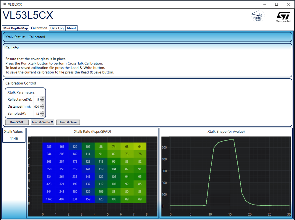

thank you for your reply and examples. I used L5 with Evaluation kit and got something like this:
[Xtalk]
Buffer=9fd800c0,04e00b54,0b08082c,08080803,9fe40140,00006798,00007013,0000783a,01e00001,00000020,9ff80040,2c2c2524,9ffc0404,0031fe6c,002fbe70,002d4b4a,0022495f,001649a9,00102c1d,000c2caa,0008e236,0033ee3b,002f7431,002924e8,001f9ba1,00179247,0010e6ac,000cabac,000a3338,0047986d,003cbe01,0032e2bb,0021ee58,001aef4b,00121a8b,000d9769,000b24e4,00668557,005aac3c,00367300,0027d7c4,001f0114,0013cc98,000fd41e,000d2c05,00684936,0063700f,003812c2,0027aacd,001fce2d,0014c567,00107088,000cb4d2,00503174,0038677a,002e324a,0020b3f2,001abb51,00123cb3,000e09fe,000b568e,0044c2eb,0035871b,002637e4,001d4bb9,0015a551,000ff345,000c6ffd,000a0eb7,0040b699,002c89b6,00286576,001f32ee,0013f93a,000dbd1d,000b0b4a,00087fe2,a0fc0100,00000000,00000003,00000000,00000000,a10c0100,00000080,00000003,00000000,00000000,a11c00c0,00007013,0c9001e0,0000002c,a1280902,00000000,00000000,00000000,00000000,00230000,01f60169,02360222,02460241,00f10228,001f004d,0006000e,00020003,00000001,00000000,00000000,00000000,00000000,00000000,00000000,00000000,00000000,00000000,00000000,00000000,00000000,00000000,00000000,00000000,00000000,00000000,00000000,00000000,00000000,00000000,00000000,00000000,00000000,00000000,00000000,00000000,00000000,00000000,00000000,00000000,00000000,00000000,00000000,00000000,00000000,00000000,00000000,00000000,00000000,00000000,00000000,00000000,00000000,00000000,00000000,00000000,00000000,00000000,00000000,00000000,00000000,00000000,00000000,00000000,00000000,00000000,00000000,00000000,a2480040,00000508,a24c0081,030c0103,00000003,a2540081,09010101,00000000,a25c0081,08010108,00000008,a2640081,01080808,00000001,a26c0084,0028a633,016afb0e,000bb003,001bb4ba,001dcecb,00000000,00000000,00000000,a28c0082,01000800,01000100,00000100,00000000,0000000f,00010304
Shape=00000000,00000000,00000000,00000000,00000000,00000000,00000000,00000000,00000000,00000023,00000169,000001f6,00000222,00000236,00000241,00000246,00000228,000000f1,0000004d,0000001f,0000000e,00000006,00000003,00000002,00000001,00000000,00000000,00000000,00000000,00000000,00000000,00000000,00000000,00000000,00000000,00000000,00000000,00000000,00000000,00000000,00000000,00000000,00000000,00000000,00000000,00000000,00000000,00000000,00000000,00000000,00000000,00000000,00000000,00000000,00000000,00000000,00000000,00000000,00000000,00000000,00000000,00000000,00000000,00000000,00000000,00000000,00000000,00000000,00000000,00000000,00000000,00000000,00000000,00000000,00000000,00000000,00000000,00000000,00000000,00000000,00000000,00000000,00000000,00000000,00000000,00000000,00000000,00000000,00000000,00000000,00000000,00000000,00000000,00000000,00000000,00000000,00000000,00000000,00000000,00000000,00000000,00000000,00000000,00000000,00000000,00000000,00000000,00000000,00000000,00000000,00000000,00000000,00000000,00000000,00000000,00000000,00000000,00000000,00000000,00000000,00000000,00000000,00000000,00000000,00000000,00000000,00000000,00000000,00000000,00000000,00000000,00000000,00000000,00000000,00000000,00000000,00000000,00000000,00000000,00000000,00000000,00000000,00000000,00000000
Grid=0031fe6c,002fbe70,002d4b4a,0022495f,001649a9,00102c1d,000c2caa,0008e236,0033ee3b,002f7431,002924e8,001f9ba1,00179247,0010e6ac,000cabac,000a3338,0047986d,003cbe01,0032e2bb,0021ee58,001aef4b,00121a8b,000d9769,000b24e4,00668557,005aac3c,00367300,0027d7c4,001f0114,0013cc98,000fd41e,000d2c05,00684936,0063700f,003812c2,0027aacd,001fce2d,0014c567,00107088,000cb4d2,00503174,0038677a,002e324a,0020b3f2,001abb51,00123cb3,000e09fe,000b568e,0044c2eb,0035871b,002637e4,001d4bb9,0015a551,000ff345,000c6ffd,000a0eb7,0040b699,002c89b6,00286576,001f32ee,0013f93a,000dbd1d,000b0b4a,00087fe2
Value=3337

We found that (using from 0 indexation) Grid part, that is Kcps/SPAD, is located in parts 13-76 of Buffer. But to get numbers right, you have to divide them by 2048. Value is maximum value in Grid. We also found some adresses/commands in it. But we have no idea what rest is supposed to represent.
Thank you for your time.
  • Vitalii
John E KVAM
It is very typical of our part to represent numbers in whatever units are handy and leave the PC to interpret the result. So your divide by 2048 just means that we stored the number in a 21.11 format.
(Where the 21 is the integer part and the 11 is the fractional part.)
Because we don't know how your MCU stores floating point numbers, this is the easist way.
Each zone gets a number of photons. And that's the 'grid' as some zones get more than others.
But we gather photons into bins. Each bin being the number of photons detected during a clock cycle.
And the 'shape' is how many photons can be expected during each clock cycle. (normalized)
So when we take a range, one multiplies the Grid value times the bin shape value for that bin to get the number of photons that have to be subtracted from the range data.
And that's now one removes the crosstalk.
0693W00000QMUBRQA5.pngSo for zone (0,0) one would multiply the 285 grid value times the 500 (in bin 10) and subract the result from the received data in bin 10 to get the target signal level. (Photon counts are ideally in the 20Million range, so the numbers are large.)
I hope that explains it.

Thank you for your time and effort. Is it right to assume that Xtalk value is the same as Xtalk margine? Or margine is different for every zone and should be calculated by the example you've provided?
WJLO
285kcps & photon number range of about 20 million => integration time is about 4s?
Is this calculation correct?
Your kcps formula is (Signal photon count/(1/integration time))/ 16 SPAD/ 1000 = kcps ???
The calibration histogram separates the one shape & 64 Grids. Will the shape be divided into 64(zones) during measuring the distance? Or is there only one shape?
