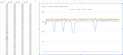

I actually found a very strange behavior on my board and I am afraid that this is layout related.
Have you ever seen something like this:
I tested it on 3 different Board with no initial config setup, no threshold, no sigma.
Pretty raw. I also tried different I2C Speeds (all of the sensors are on the same bus).
This one sensor show very strange numbers, 1536 for example the most and not much variation. Any idea what could cause this?

This is an educated guess.
Are all these sensors pointing the same direction?
When 2 sensors are pointed at the same place, and there is a reasonably bright target surface, they generally do not interfere with each other. But sometimes they do.
To prevent EMI we use clock dithering. And this movement of the base timing tends to ensure the clocks don't line up. But just due to the randomness, they sometimes do.
one can keep a running average to even out the data. Or one can use the Inter-measurement period on the sensors to try to get them out of lock-step. Or one can slightly tilt one so the Field of View have less overlap. Generally this only happens with near or reflective targets. Can you avoid those?

All 4 sensors point into the same direction and they are exactly 4cm appart from eachother.
There is actually no object in front of the sensor when measuring and I also tried it by using one by one, disabling all others while the one is measuring (just to make sure)
The dips you see is distance. So there is no shiny or reflective object in front.
could it be something else? This sensor returns 0 mm distance if I apply the config to it.

It bothers me that you are getting some 1600 mm when you say there is no object in front of your sensors. With no object you should be getting a 'no signal' Range Status =2. That means any range information is probably suspect.
It looks to me like there is an object at 1.6 meters or so. Your ceiling perhaps?
Most MCUs are a lot faster than that tiny sensor. If you toggle the Xshut at MCU speeds you could well get the sensor into a half-reset state. When restarting, give it a few milliseconds between lower and raising the XShut pin.
Rather than look at the I2C, gather up the range_status, the distance, the signal strength and the ambient. Look for your clues in that data.
The VL53L4CD is limited to about 1.3M. Yet you are getting 1.6M. This means that your ceiling is, perhaps, a nice reflective white. But I'm guessing you are getting a Range status of 4. This happens when one of the two sub-ranges does not return a result and the other does. It's a warning that something odd is going on. (You can get it with motion or if you target starts to wrap around and a 2M target shows up as a 40cm target. Radar aliasing is what this wrap condition is called.)

When I run this pointing to my ceiling I get this result
Sensor 1 Average: 1819
Sensor 2 Average: 70
Sensor 3 Average: 1826
Sensor 4 Average: 1815
where the values of sensor 2 are as follows
distance: 37 [- : Warning! Signal is below the defined threshold]
distance: 53 [- : Warning! Signal is below the defined threshold]
distance: 55 [- : Warning! Signal is below the defined threshold]
distance: 77 [- : Warning! Signal is below the defined threshold]
distance: 238 [- : Warning! Signal is below the defined threshold]
distance: 74 [- : Warning! Signal is below the defined threshold]
distance: 61 [- : Warning! Signal is below the defined threshold]
distance: 70 [- : Warning! Signal is below the defined threshold]
distance: 36 [- : Warning! Signal is below the defined threshold]
distance: 86 [- : Warning! Signal is below the defined threshold]
distance: 0 [- : Warning! Signal is below the defined threshold]
distance: 84 [- : Warning! Signal is below the defined threshold]
distance: 41 [- : Warning! Signal is below the defined threshold]
distance: 87 [- : Warning! Signal is below the defined threshold]
distance: 58 [- : Warning! Signal is below the defined threshold]
distance: 113 [- : Warning! Signal is below the defined threshold]
distance: 25 [- : Warning! Signal is below the defined threshold]
distance: 54 [- : Warning! Signal is below the defined threshold]
distance: 95 [- : Warning! Signal is below the defined threshold]
distance: 33 [- : Warning! Signal is below the defined threshold]
distance: 65 [- : Warning! Signal is below the defined threshold]
distance: 261 [- : Warning! Signal is below the defined threshold]
distance: 76 [- : Warning! Signal is below the defined threshold]
distance: 46 [- : Warning! Signal is below the defined threshold]
distance: 66 [- : Warning! Signal is below the defined threshold]
distance: 16 [- : Warning! Signal is below the defined threshold]
distance: 40 [- : Warning! Signal is below the defined threshold]
even tho they are all pointing to the ceiling.
Now I left the device over night and all 4 sensors on my board showing the same ceiling values except: one of them triggers the interrupt permanently.

May 6, 2024 7:08 AM UTC
@John E KVAM it would be nice to get a littlebit better and faster support here. is that possible?
The I2C Address issue from earlier does not fix the problem with the sensors.
Didn't you said, that the sensor should not give back 0mm?
I see 0mm often on this sensors. Whenever it was 0 I was printing all data:
Sensor VL53_2 [0x1e]
Distance: 1651 mm [✗ Error: Phase out of valid limit]
Distance: 1871 mm [✗ Error: Phase out of valid limit]
Distance: 1666 mm [✗ Error: Phase out of valid limit]
Distance: 1903 mm [✗ Error: Phase out of valid limit]
Distance: 1661 mm [✗ Error: Phase out of valid limit]
Distance: 1867 mm [✗ Error: Phase out of valid limit]
Distance: 1647 mm [✗ Error: Phase out of valid limit]
Distance: 1888 mm [✗ Error: Phase out of valid limit]
Distance: 1875 mm [✗ Error: Phase out of valid limit]
Result: SPAD=203, Signal=592, Ambient=392, Sigma=8, Distance=0, Signal/SPAD=2, Ambient/SPAD=1 | ✗ Error: Phase out
 of valid limit
Distance: 0 mm [✗ Error: Phase out of valid limit]
Distance: 1876 mm [✗ Error: Phase out of valid limit]
Distance: 1669 mm [✗ Error: Phase out of valid limit]
Distance: 1879 mm [✗ Error: Phase out of valid limit]
Distance: 1896 mm [✗ Error: Phase out of valid limit]
Distance: 1667 mm [✗ Error: Phase out of valid limit]
Distance: 1894 mm [✗ Error: Phase out of valid limit]
Result: SPAD=203, Signal=616, Ambient=376, Sigma=7, Distance=0, Signal/SPAD=3, Ambient/SPAD=1 | ✗ Error: Phase out
 of valid limit
Distance: 1882 mm [✗ Error: Phase out of valid limit]
Result: SPAD=203, Signal=648, Ambient=368, Sigma=7, Distance=0, Signal/SPAD=3, Ambient/SPAD=1 | ✗ Error: Phase out
 of valid limit
Distance: 1865 mm [✗ Error: Phase out of valid limit]
Distance: 1664 mm [✗ Error: Phase out of valid limit]
Distance: 1662 mm [✗ Error: Phase out of valid limit]
 The setup has not changed - the device is still pointing towards my ceiling without any other object close by.
Why do they return 0 mm as distance here?
John E KVAM
May 6, 2024 2:08 PM UTC
You are of course correct. If one uses the 7-bit base address, they can go up by one.
So that wasn't it.
Let's talk about:
 This happens when the two sub-ranges do not match.
We use two sub-ranges with different Pulse Repetition Intervals (PRI) to prevent something called radar aliasing or wrap-around. Aliasing happens when a target is past the max distance the sensor can range. The photons from pulse N were received AFTER pulse N+1 got sent out. So, a target at 4.2Meters would be detected at 0.4Meters.
With two different PRI we can detect this condition. But it can be caused by other things.
Motion can cause the two sub ranges to disagree - but both are valid.
A weak return signal can cause one range to fail, and the other pass.
In your case that ceiling is just bright enough that it's detected by one on the ranges, but not the other.
You might increase your timing budget. This will allow both ranges to pass and you'd get better accuracy.
I still don't know what is going on. Perhaps covering the some of the sensors with bits of paper to determine it there is some interaction we don't understand?
- john
If this or any post solves your issue, please mark them as 'Accept as Solution' It really helps. And if you notice anything wrong do not hesitate to 'Report Inappropriate Content'. Someone will review it.
DrD00mAuthor
May 7, 2024 12:14 PM UTC
@John E KVAM Why do you think this is an issue?
It measure the correct distance more or less but the ceiling is clearly out of the range (the spec says 1.3m). So this is fine, right?
I would be more interested, why it shows 0mm some times even tho I do not change anything on the setup.
We discovered aglitch yesterday on the data line.
This should not be there I think. I changed the pull-up resistor on one of the boards to be 4.7k instead of 2.2k and the spike was gone. But also reducing the I2C speed from 400kHz to 300kHz made this spike disappear. Not sure what is causing this spike tho but I think it is coming from the ESP32-S3.
Since then I did not had the problem with a sensor being stuck in the interrupt.
But still this value 0mm is strange. The sensor measures the distance in default mode to determine a threshold, then sets the sensor into low power mode and sets this threshold to be interrupted when below.
To do so I measure 25 times and take the average of that measurment. So far this worked pretty well but if the sensor sends 0mm the average will be wrong. I even had the situation where the sensor was sending only 0mm.
So what is the default behavior of the sensor or how should I handle such situations?
Should I ignore 0mm values?
I do not mind that while measuring the distance, if there is no object. That can happen if the sensor points into nothingness - then I will set the threshold to be 1300mm anyway. But should the sensor give me a value every time or 0mm a valid measurment? This is what I still don't understand
