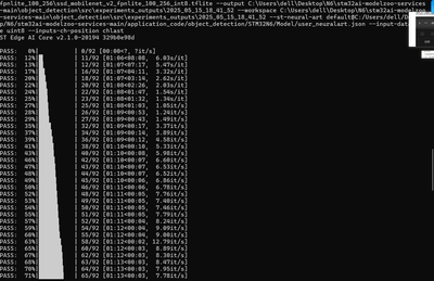

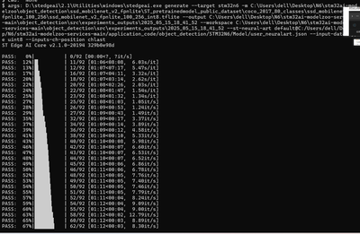

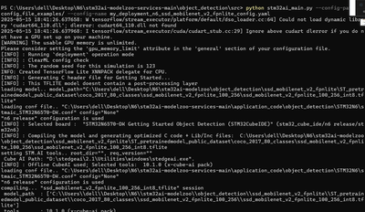

I'm currently deploying the object detection of stm32modelzoo. After entering the command "python stm32ai_main.py --config-path ./config_file_examples/ --config-name deployment_n6_ssd_mobilenet_v2_fpnlite_config.yaml", an error occurred. Could someone please help me solve it?
imization 3 --Os --Omax-ca-pipe 4 --Ocache-opt --enable-epoch-controller --output-info-file "c_info.json"
PASS: 91%|█████████▏| 84/92 [01:21<00:12, 1.60s/it]
<<<< DONE EXECUTING NEURAL ART COMPILER
PASS: 91%|█████████▏| 84/92 [01:24<00:12, 1.60s/it]
PASS: 92%|█████████▏| 85/92 [01:25<00:16, 2.35s/it]

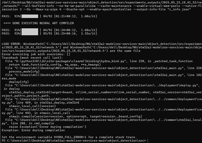

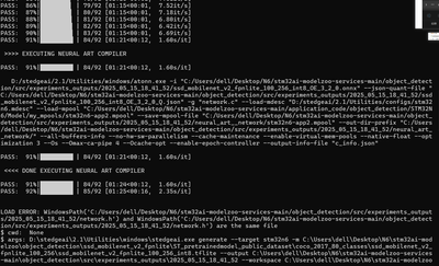

LOAD ERROR: WindowsPath('C:/Users/dell/Desktop/N6/stm32ai-modelzoo-services-main/object_detection/src/experiments_outputs/2025_05_15_18_41_52/network.h') and WindowsPath('C:/Users/dell/Desktop/N6/stm32ai-modelzoo-services-main/object_detection/src/experiments_outputs/2025_05_15_18_41_52/network.h') are the same file
Error executing job with overrides: []
Traceback (most recent call last):
File "D:\python310\lib\site-packages\clearml\binding\hydra_bind.py", line 230, in _patched_task_function
return task_function(a_config, *a_args, **a_kwargs)
File "C:\Users\dell\Desktop\N6\stm32ai-modelzoo-services-main\object_detection\src\stm32ai_main.py", line 228, in main
process_mode(cfg)
File "C:\Users\dell\Desktop\N6\stm32ai-modelzoo-services-main\object_detection\src\stm32ai_main.py", line 102, in process_mode
deploy(cfg)
File "C:\Users\dell\Desktop\N6\stm32ai-modelzoo-services-main\object_detection\src\../deployment\deploy.py", line 111, in deploy
stm32ai_deploy_stm32n6(target=board, stlink_serial_number=stlink_serial_number, stm32ai_version=stm32ai_version, c_project_path=c_project_path,
File "C:\Users\dell\Desktop\N6\stm32ai-modelzoo-services-main\object_detection\src\../../common/deployment\common_deploy.py", line 469, in stm32ai_deploy_stm32n6
stmaic_local_call(session)
File "C:\Users\dell\Desktop\N6\stm32ai-modelzoo-services-main\object_detection\src\../../common/deployment\common_deploy.py", line 443, in stmaic_local_call
stmaic.compile(session=session, options=opt, target=session._board_config)
File "C:\Users\dell\Desktop\N6\stm32ai-modelzoo-services-main\object_detection\src\../../common\stm32ai_local\compile.py", line 208, in cmd_compile
raise Exception('Error during compilation')
Exception: Error during compilation
Set the environment variable HYDRA_FULL_ERROR=1 for a complete stack trace.
PS C:\Users\dell\Desktop\N6\stm32ai-modelzoo-services-main\object_detection\src>

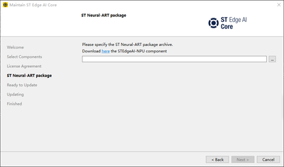

So is there any other solution for now? Can I use another version of stedgeai? For example, 10.0.0,
I can't download ST EdgeAI Core 2.0.0. I need to provide STEdgeAI-NPU component, but I can't find where to download the component? Do you have a solution?
I used CubeMX to download x-cube-ai 10.0.0, and finally I also need to provide the stedgeai-stneuralart-10.0.0.zip file. I also don't know where to download it. How can I solve it? Looking forward to your reply, thanks.

GHORT.1
A new release will be pushed this week. It will fix this issue. You are using stedgeai 2.1 which is not compatible with the current version of the model zoo.
I'll update the post when it's pushed in github.
