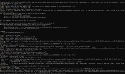

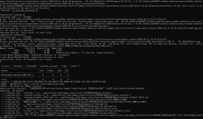

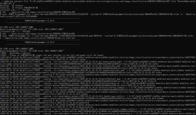

@LQC_ You should be able to run following the instructions here: https://github.com/STMicroelectronics/stm32ai-modelzoo-services/blob/main/image_classification/deployment/README_STM32N6.md
TLDR; you need to put both the boot switches to the right and reconnect the power cable before you run the command
python stm32ai_main.py --config-path ./src/config_file_examples/ --config-name deployment_n6_config.yaml
Once done, as seen in your screenshot; put both the switches back to the left and reconnect the power cable.
2025-05-21 4:50 AM
I tried turning both switches to the right and executing
but it still didn't work. Do I have to use a USB-C to USB-C cable? I use a 5V-USB-SNK power supply and an STLink USB to USB-C.
