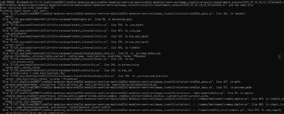

E011(ConfigurationError): Neural-Art configuration: Cannot find the Neural-Art compiler
llcc
Hello! How can I downloaded the en.stedgeai-stneuralart-10.0.0.zip? I can't find the file in ST Edge AI Core. Thanks!

Hello @llcc , @sheperdhannigan , @LQC_
The status of the NPU part of the St edge ai core changed.
Before, because of export control laws imposed by the US, we were obligated to provide the NPU part behind a form on ST.com.
So you had to first install ST Edge AI Core and then the NPU part (en.stedgeai-stneuralart-10.0.0.zip)
Now that it is not a thing anymore, the stedgeai core can be downloaded here with the npu addon directly inside:
https://www.st.com/en/development-tools/stedgeai-core.html
