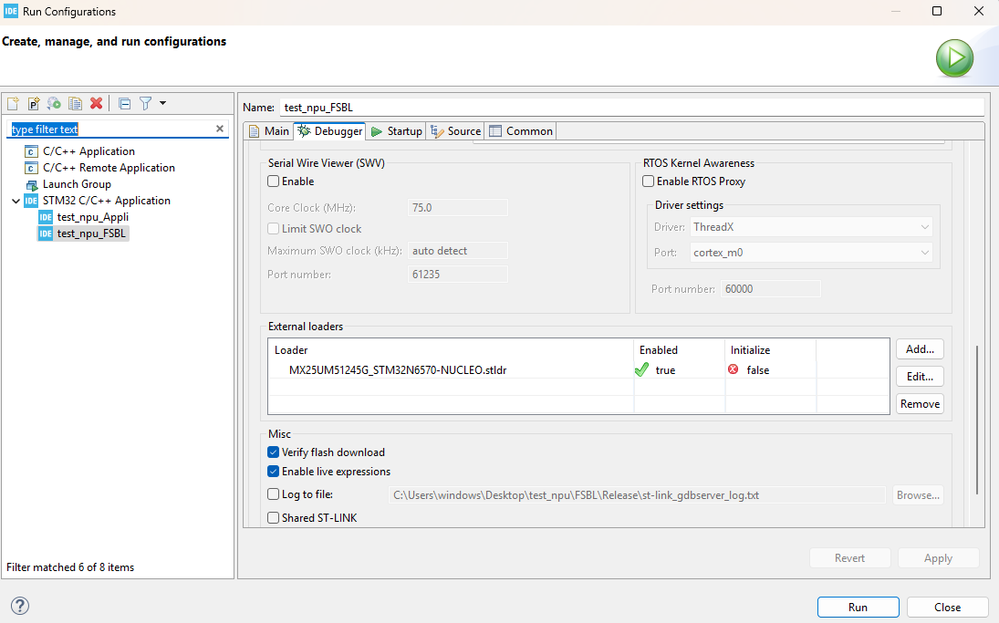

I generated the project using STM32CubeMX, setting up LPUART1 for communication and configuring it to have only the FSBL and a secure application. X-Cube-AI was selected to be part of the application.

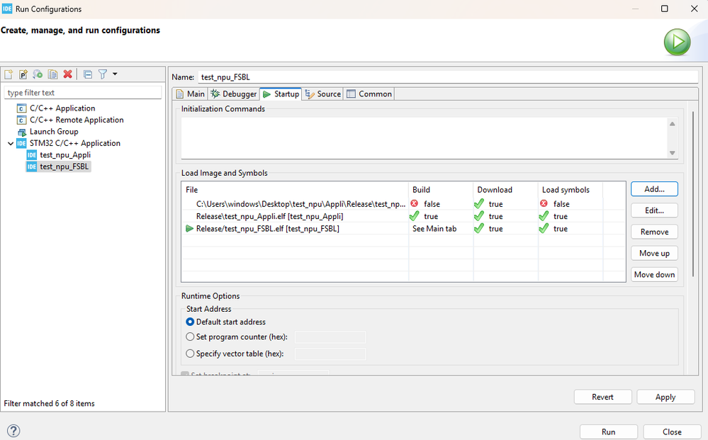

I generated the project, compiled it, and set up the run configuration in STM32CubeIDE as follows:
The first file in the latter figure is a signed .bin file obtained according to the guide here: https://community.st.com/t5/stm32-mcus/how-to-debug-stm32n6-using-stm32cubeide/ta-p/800547
I set to download it at the origin address of the RAM (0x34000400).
For debugging, I added code in the FSBL to turn on the LEDs and print a message, and I noticed that the FSBL runs, but the application does not start (like if it hangs on the while loop auto-generated in the fsbl code:

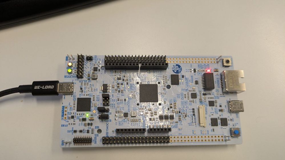

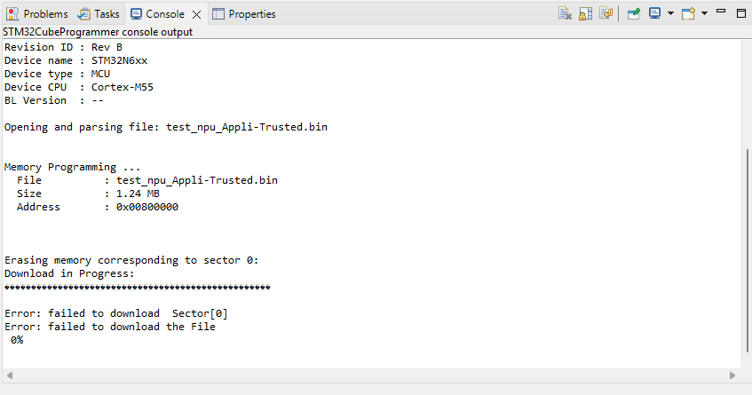

UPDATE:
I still can't manage to run the application in RAM using Execution in Place (XIP).
I'm testing with a simple program that turns LEDs on and off. The .ioc project and the resulting code are in the zip file attached.
I can see the blue LED blinking as defined in the FSBL and executed before the jump, but it seems that the jump to the application in memory doesn't occur. The green LED, which is supposed to blink as part of that application, never does.
I've double-checked the code, the linker script, and the parameters in the .ioc file multiple times, but I can't figure out what's wrong.
I attach also the OTP table in case you can see some sort of problem...
