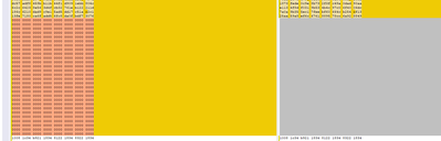

With STM32CubeProgrammer v2.21, there has been a change where the tool doesn't align automatically the payload to 0x400 with padding bytes for N6. Here's a screenshot of where the change is in an example binary:
However, this is highlighted in this warning message:
And in signing tool help here:
To solve this, add the -align or --align to the signing CLI command and it should be fine.
Hope this solves the issue.
Aziz
Thank you @Aziz BRIGUI this fixes the issue for me!
