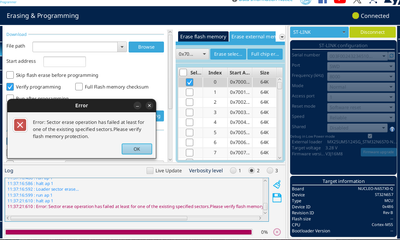

I've recently been trying to get an LRUN application up and running on the NUCLEO-N657X0-Q board. Similar to the posts in https://community.st.com/t5/stm32cubeprogrammer-mcus/stm32n6570-dk-unable-to-erase-external-flash/td-p/757897, I cannot access the flash for erasure, with errors indicating to verify flash memory protection.
I currently have the BOOT0 jumper on 1-2 (for 0) and BOOT1 on 2-3 (for a logical 1), which should be putting me into the Development boot mode. For external loaders, I have MX25UM51245G_STM32N6570-NUCLEO selected.
I've tried both full chip erase and sector erase, both giving me errors that tell me to verify flash memory protection.
Please advise, I'm not sure what I'm doing wrong. This is my first time attempting to flash the memory.
EDIT: I should've mentioned, I'm using STM32CubeProgrammer 2.20.0. I've tried this on both Windows 11 and Ubuntu 24.04
EDIT #2: I have also attached the verbose log file after I hit "full chip erase" and a single sector
EDIT #3: I've also tried bypassing the chip erase and loading my signed bin file into flash. That's also locked me out, as expected.

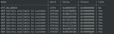

Scrubbing the OTP output, I see some deltas between the output of my NUCLEO board and the "prog-locked by ST" status of table 17 of RM0486:
Per table 17 of RM0486, OTP_HW_WORD4/OTP4 should've been prog-locked by ST, and it shows as not being locked on my board.
I don't think I programmed OTP260-267, but they show as programmed. Regardless, I think those shouldn't effect the flash operation, as they seem to be intended to be used by the application only.

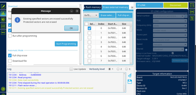

After coming home from work, I tried getting this to work again. The very first time I plugged in the NUCLEO board and tried erasing a sector, I got this:

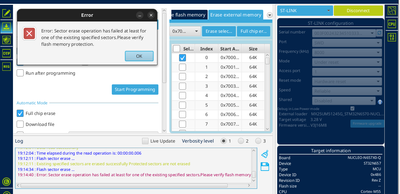

Which is a success! however, subsequent attempts to erase the chip lead to the same issue:
Now, I did think to myself, "maybe there's a hardware issue", as I had success once after the board was powered off for 24 hours. I've been able to unplug the board and leave it sitting there (letting capacitors discharge) for 3 or 4 attempts so far and I have the same behavior of it successfully clearing the sector the very first time, followed by not being able to write to the flash any more.
Unless there's something I'm missing, I don't know if I can do anything else about this.

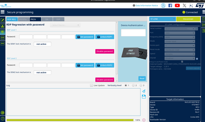

I do not know how to read or set the RDP level, this is the closest menu I've found to that:
Can you show me how to read it out?
Further research has led me to believe that RDP isn’t present on an STM32 that doesn’t have internal flash, like this one?
