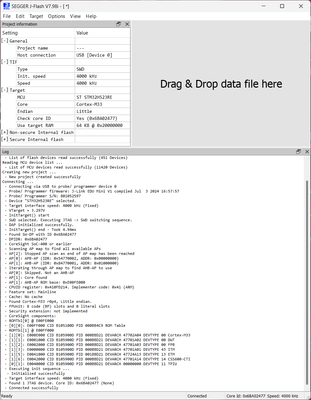

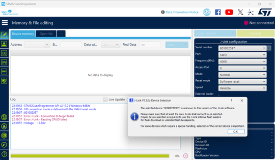

I am trying to connect to a STM32H523RET MCU via SWD using a J-link Debugger (CubeProgrammer v2.17.0).
Reading the Product ID fails, so I get asked to select the MCU manually.
Unfortunately the list does not contain any STM32H52x MCU
But when I am trying to connect via Jlink - Commander I can find der MCU in the list and also connect to it:
Does anybody have an idea, why I can't find the MCU in the list when using the CubeProgrammer?
Thanks for any hints.

Hi @WhoIsJohnGalt ,
After check, this issue is related to the access port when connecting with J-Link and will be fixed in the upcoming release of STM32CubeProgrammer.
For now, you can manually change the access port from 0 to 1, which should resolve the issue with the current version.

CubeProgrammer:
Trying to connect with "Connect Under Reset" mode + "Software Reset" leads also to a failed PRODID read (as shown in first post".

Hi @WhoIsJohnGalt ,
Thanks
Imen
Thanks, I can confirm this worked for me. Now also the connection in the CubeIDE works as well.
