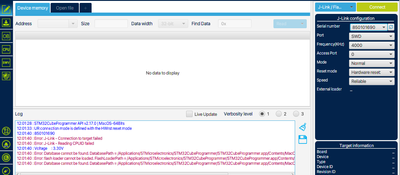

I'm trying to use the STM32CubeProgrammer with the newly supported J-Link settings, but can't seem to get it to work.
I'm using:
  • STM32CubeProgrammer: v2.17.0
  • STM32H573I-DK
  • SEGGER J-Link PLUS: SEGGER J-Link Commander V8.10c (Compiled Oct 16 2024 16:20:30)
I have set the External Debug jumper JP1, and have connected my SEGGER to the DK. I can connect to the DK via the SEGGER using JLinkExe, can debug using JLinkGDBServer, etc. JP4 is set to USB-PD, and I have a usb cable plugged into CN17.
I'm trying to connect to the board using the STM32CubeProgrammer, but am running into issues. With the GUI, I get the following:
16:30:49 : UR connection mode is defined with the HWrst reset mode
16:30:54 : xxxxxxxx ---> (have removed SN here, it does show valid number)
16:30:54 : Error: J-Link - Connection to target failed
16:30:54 : Error: J-Link - Reading CPUID failed
16:30:54 : Voltage : 3.31V
16:30:54 : Error: Database cannot be found. DatabasePath = /Applications/STMicroelectronics/STM32CubeProgrammer/STM32CubeProgrammer.app/Contents/MacOs/bin/../Data_Base/STM32_Prog_DB_0xAAA.xml
16:30:54 : Error: flash loader cannot be loaded. FlashLoaderPath = /Applications/STMicroelectronics/STM32CubeProgrammer/STM32CubeProgrammer.app/Contents/MacOs/bin/FlashLoader/0xAAA.stldr

Hello @colinmurphygc,
This is a known issue where the Programmer should automatically switch to AP 1 when it fails in AP 0, as it does with ST-LINK. This will be fixed in the next release.
For now, you can manually change the access port from 0 to 1.

Ah, it seems to work with Access Port set to 1.
I've had a quick read through the docs, and can't seem to find what the different access ports relate to on the STM32H573-DK, do you know what these are?

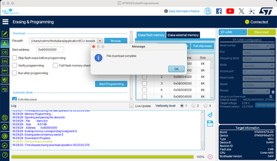

I'm trying to interact with the external flash on the DK, and having some more issues. I'm using the `MX25LM51245G_STM32H573I-DK-RevB.stldr` external loader. I can read the flash and erase sectors, but the program immediately crashes when I try to program a file.
Using the ST-LINK with the same external loader and the same .bin, I can program successfully:
