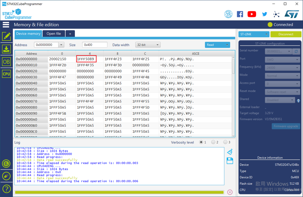

I read the contents of 0x00000000 with BFB2=1. It seems the mcu will start from bootloader. Which is like AN2606 says, system bootloader will help to check bank2 then do bank swap. . Is it really possible to check if system boot from bank2 with cube programmer? cube programmer will halt the mcu on connection

But bootloader doesn't re-map neither BANK1 nor BANK2 to 0x00000000

But after bootloader jumps to 0x08000000, 0x00000000 still remains bootloader's vector table
