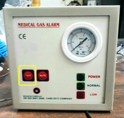

@thealbertdev wrote:
I'm probably getting lost in translation, but how can I add the while(1) function in the code to test the IWDT and then, without modifying the code, release it in production and prevent the device from restarting all the time?
You have some sort of test command or button or whatever to activate this test.
Maybe not so prominent & user-accessible as that, but ...
Or, like your HardFault approach, have it controlled by a flag that's only accessible via the debugger.

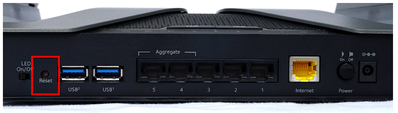

Addendum
You could label the button 'Reset'.
Maybe also have it recessed, as is common for 'Reset' buttons.
Then the user knows that it will cause the device to reset.
And the test becomes simply, "does the 'Reset' button work?"
