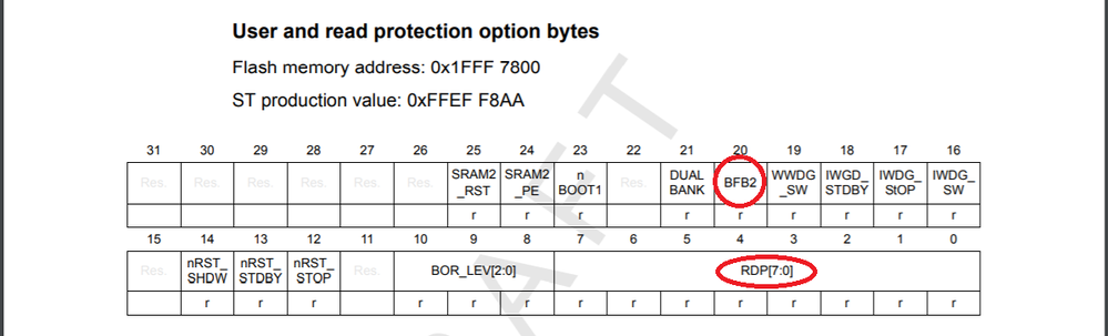

2021-02-22 07:07 AM
Hi @RHaag.1 ,
Writing OB needs a specific procedure describes in MCU reference manual : "FLASH option bytes" section.
It is different from writing to flash.
The two OB BFB2 and RDP are configured in the same register , may be your are modifying the RDP when BFB2 is modified by your application.
Hope this helps you, when your question is answered, please close this topic by choosing Select as Best. This will help other users find that answer faster.
Houda

2021-02-23 07:19 AM
Hi @RHaag.1 ,
For RDP default value is 0xAA (as you can see in the snapshot I sent you the ST production value is 0FFEF F8AA).
Can you please tell me what do you mean by the "inversion data mismatch" in OBs? it is not a known notion for me.
Houda
