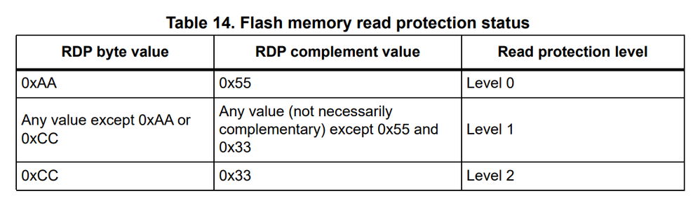

On a STM32L4 design, we no longer have an SWD connection to the processor: using STM32CubeProgrammer reports
ST-LINK SN : 39FF6A064243383912381057
ST-LINK FW : V2J36S7
Voltage : 3.26V
SWD freq : 4000 KHz
Connect mode: Normal
Reset mode : Software reset
Device ID : 0x461
UPLOADING OPTION BYTES DATA ...
Bank : 0x00
Address : 0x40022020
Bank : 0x01
Address : 0x40022044
UPLOADING ...
Address : 0x8000000
Read progress:
Error: Data read failed
SWD works fine in the design in general, also also ran on this particular device. An idea what is missing?
Or to put it the other way round: what do we need for a running SWD? Supply, connection to the SWD pins of course, but what further? IMHO we don't need running CPU core or clocking on it for example....
Thank you
Ralph

Hi @RHaag.1​ ,
In this case the value of RDP OB can be any value other than 0xAA and 0xCC (so it can be 0xFF).
Houda

Hi Houda,
hm, is there an error in the ref manual with level 0 / 1 here?
Anyhow, I know programming any value other than 0xAA and 0xCC will lead to level 1, but I'm sure ST knows what value I should read back in assumed case with mismatch in comparison of stored option byte! Is it 0xFF or not?
Regards
Ralph
Houda GHABRI
Hi @RHaag.1​ ,
You can refer to table 14 in RM0351 3.5 Flash memory protection :
0693W000007Zhn9QAC.pngHouda
RHaag.1
Hi Houda,
it's a valuable discussion, but I still don't know the RDP value when the comparission doesn't match. I know it can be "my" 0xFF, but I'm quite sure ST implemented a certain value in this case not a "could be anything except..." :)
Regards
Ralph
