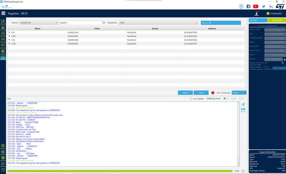

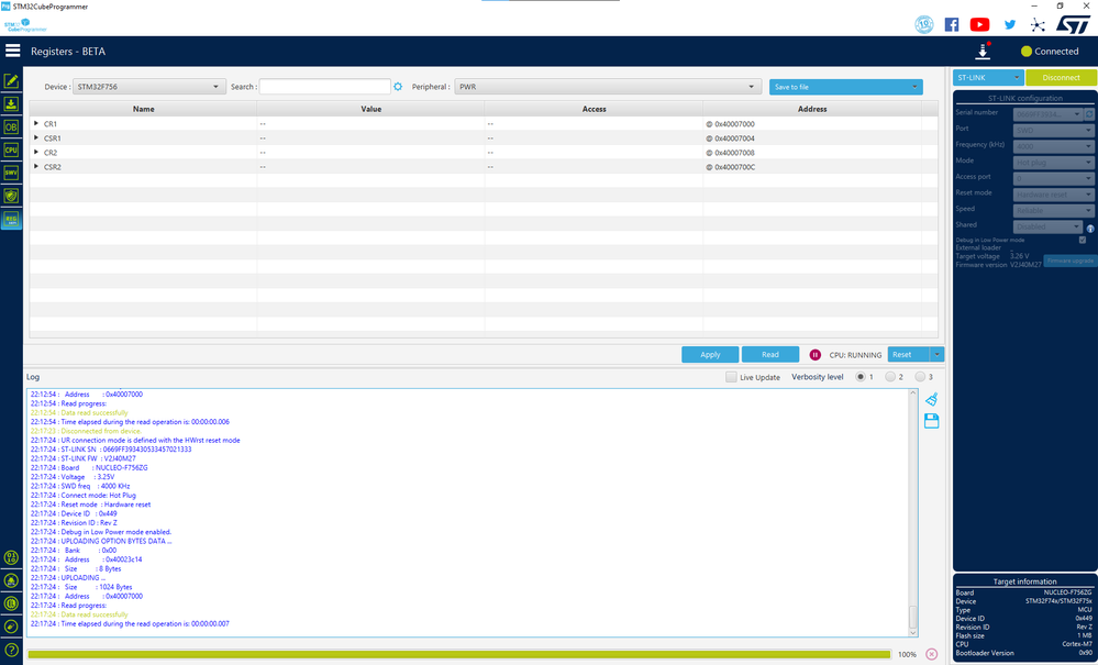

Hi.
Before enter to standbyMode i can accesss to registers in "register" tab, but after return from standbyMode I can't.
First picture present state before enter to stanbyMode
After return from standbyMode I don't see registers:

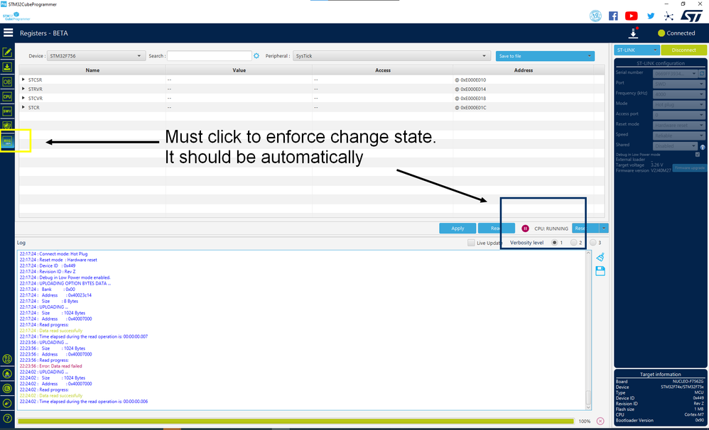

_legacyfs_online_stmicro_images_0693W00000biRAEQA2.png but there are still visible in "memory and file editing" tab:
I also notice that after change MCU core state, a icon with text "CPU" doesn't update. I must click once again on icon on left bar to force update:

For the debug interface to work in low-power modes, it has to be enabled. Read about it in the following article (issue 3):
https://community.st.com/s/question/0D53W00001bnh8dSAA/how-to-enter-standby-or-shutdown-mode-on-stm32
Senior III
May 16, 2023
I don't see the connection between my post and your link. Moreover I think it is stm32cubeprogrammer issue as application
Dudo
Piranha
Principal III
May 23, 2023
If you do not enable the respective bits in DBGMCU_CR register, entering low-power mode disables the debug interface on MCU and the debugger looses connection. J-Link sets these bits automatically, but ST-LINK, of course, does not...
