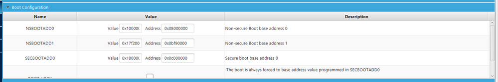

I am using MB1549C DK which has STM32U575ZIT6 MCU.
I have enabled trust zone as well as dual bank.

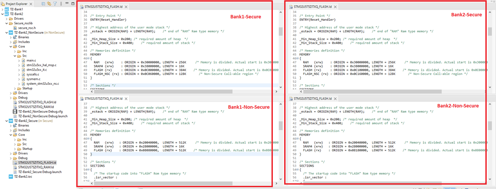

I have four hex file,
  1. Two files for bank1, secure and non-secure firmware. uploaded at 0xC000 0000
  2. Two files for bank2, secure and non-secure firmware. uploaded at 0xC100 0000
At bootup, I have read swapbank bit of OPTR reg.

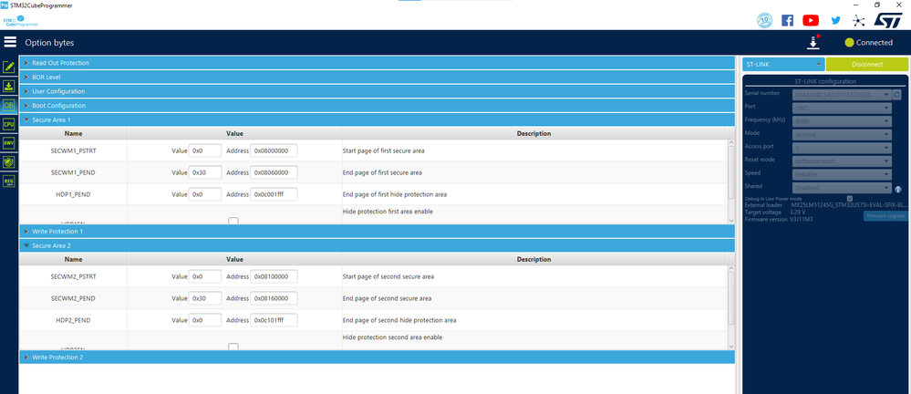

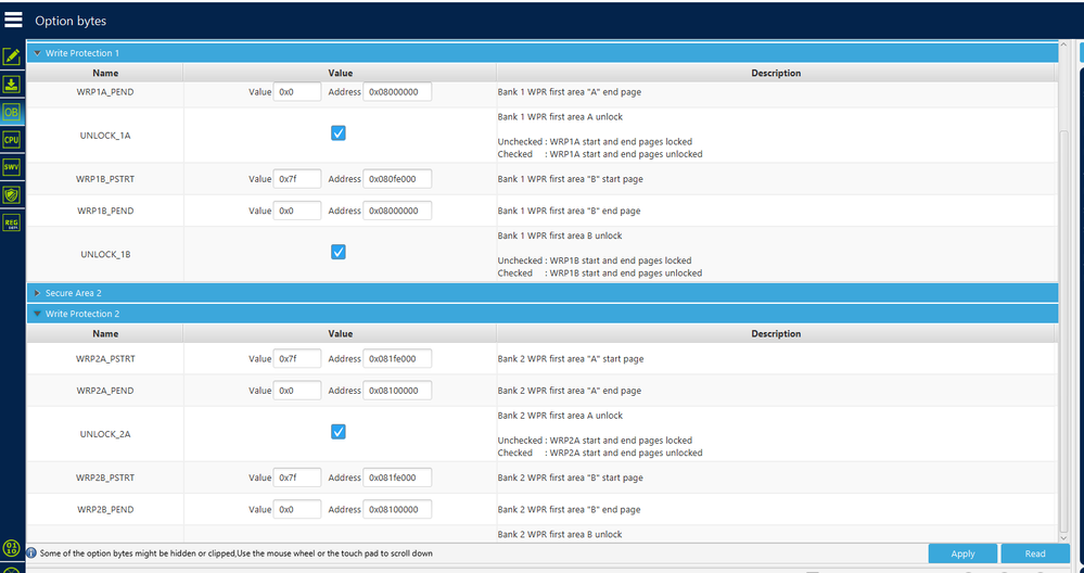

I am able to update SWAPBANK bit and also able to read.
But when SWAPBANK is set to 1, at that time, firmware located at BANK2 doesn't run. It always run BANK1 firmware.
Here I have attached flash ld. file for all four hex file. and option byte configuration.
I want to switch between two firmware which are located in bank1 and bank2 in trust zone.
Can you please guide me, if anything I have missed ?
Does STM32U5 supports dual boot?

Hello @vijay_03​,
Linker file should not get changed from Flash bank 1 to bank2.
An internal ticket (ID 152745) is submitted in order to update the example swap bank.
(PS: ID 152745 is an internal tracking number and is not accessible or usable by customers).
STM32U5 does not support dual boot.
