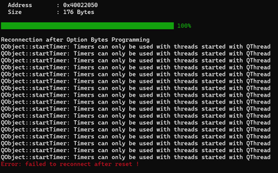

I am using the STM32CubeProgrammer API (v2.20.0) on Windows 11 using the Visual Studio UART example as a base. Everything works fine, however this issue is slowing down the programming workflow.
After programming the MCU option bytes to RDP1 (or Closed state on some newer devices), there is a long delay (20 to 30 seconds) during the attempts to reconnect to the device. I already expect that the reconnection attempt will fail, so is there a way to reduce the time or number of reconnection attempts? Or a way to cancel the current operation? The time taken for failed reconnection attempts is 2x longer than the actual programming of the MCU.
I noticed that there is a getCancelPointer() function in the API, but I have found no documentation or examples on how to use it. Is it possible to use this or is there some other way?
Edit: Added info - using UART to program the device
 * \brief This routine allows to drop the current read/write operation.
 * \return 0 if there is no call for stop operation, otherwise 1.
volatile int* getCancelPointer();

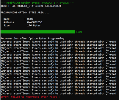

Hello @fma,
You can use the new no reconnect option available in CubeProgrammer v2.20. Example:
sendOptionBytesCmd((char*)"-ob RDP=0xBB noreconnect");
Hope this helps,
Aziz
fmaAuthor
August 28, 2025
I have tried this on my STM32H5 and there is no error, but it still attempts to reconnect
Aziz BRIGUI
February 25, 2026
Hello @fma,
Issue is fixed in the latest STM32CubeProgrammer release available here.
Aziz
