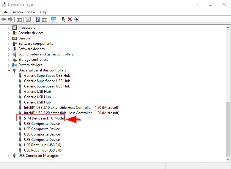

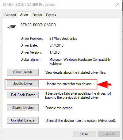

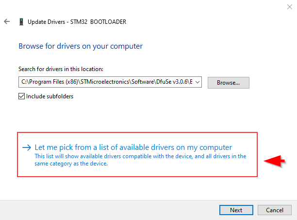

I actually found a way to still use the old DFU programming mode. To get it to work, you have to set your device into the boot loader mode that you would do normally to program it in DFU mode. Then find the driver "STM32 Bootloader" in device manager and right-click on it to select Update Driver.
After that choose:

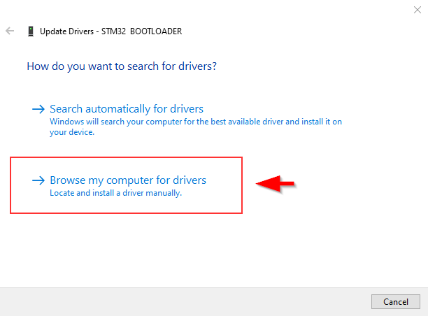

Browse my computer for drivers (Locate and install a driver manually)
Then pick:

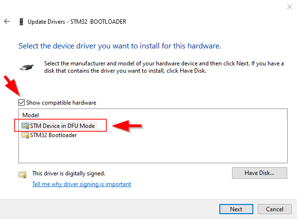

Let me pick from a list of available drivers on my computer
Check the checkbox "Show compatible hardware"
Now you'll see 2 options to pick from
  • STM Device in DFU Mode
  • STM32 Bootloader
Pick STM Device in DFU Mode and click next. The installing driver message will show up and then it's done.
Now in Device Manager, you'll see STM Device in DFU Mode instead of the STM32 Bootloader.

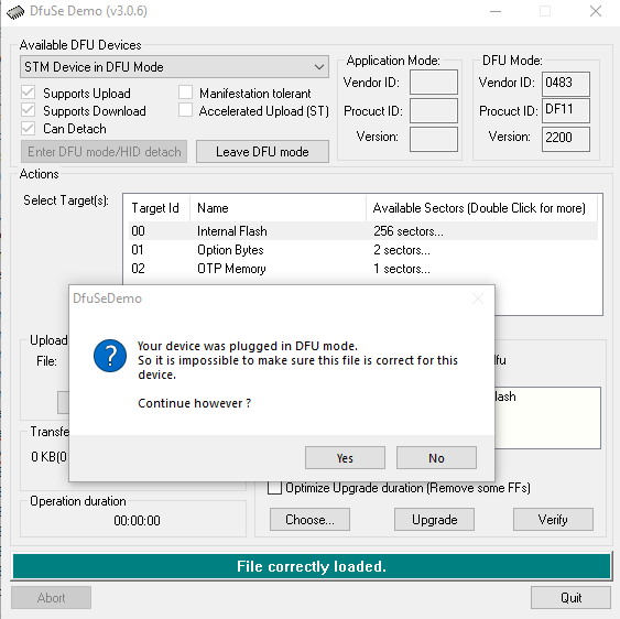

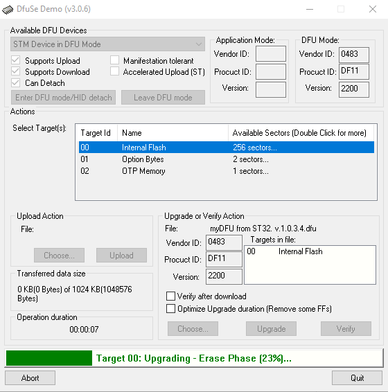

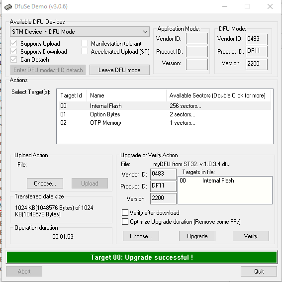

Now your DFUse demo program will be able to detect the device and still program with the DFU file.
0693W00000LvVRzQAN.pngUnfortunately, you have to do this per device since any new STM device discovered by Windows for the first time will choose the STM32 Bootloader. Once you have done it once, Windows would remember that it's a DFU Mode device.
If you are writing your own DFU loader, beware that the newer STM32L4x devices are not supported right off the bat so you have to figure out the correct mapping for the byte data. I'll try to push my Csharp codes on GitHub that successfully do a DFU programming in my application.
You can always go back to the STM32 Bootloader driver by doing the same process here but pick the STM32 Bootloader driver instead.
