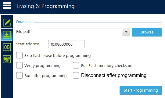

I'd like to have an option for "auto-disconnect" (+ reset) after programming.
Or is that already available?

Hello LCE, thank you for your feedback !
Currently, you need to manually click the Connect/Disconnect button next to the programming interface selector :
Would adding a checkbox in the GUI, as shown below, meet your needs ? If so, I assume it should also be possible to save it with the other configuration settings.
Thanks,
Max
Exactly something like this!
Maybe one more option: "(Hardware) Reset after Disconnect"
