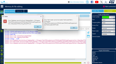

I`ve downloaded and installed the latest application and was told that the CubeProgrammer could support J-Link now.
the GUI shows that JLink device can be selected:
I clicked the connect bottom, the chip select window of JLink was popped out:
after correct chip was selected, the error window showed below:

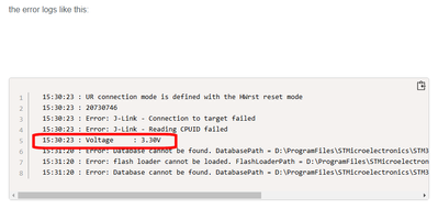

the error logs like this:
  15:30:23 : UR connection mode is defined with the HWrst reset mode
  15:30:23 : 20730746
  15:30:23 : Error: J-Link - Connection to target failed
  15:30:23 : Error: J-Link - Reading CPUID failed
  15:30:23 : Voltage     : 3.30V
  15:31:20 : Error: Database cannot be found. DatabasePath = D:\ProgramFiles\STMicroelectronics\STM32Cube\STM32CubeProgrammer\bin/../Data_Base/STM32_Prog_DB_0xFFF.xml
  15:31:20 : Error: flash loader cannot be loaded. FlashLoaderPath = D:\ProgramFiles\STMicroelectronics\STM32Cube\STM32CubeProgrammer\bin/FlashLoader/0xFFF.stldr
 I wander if the app support jlink probe, if not, why I can select it?

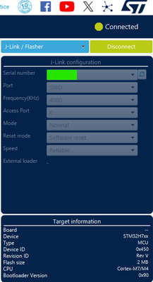

On the H755 board, my J-Link works great. It recognizes the Device ID 0x450:

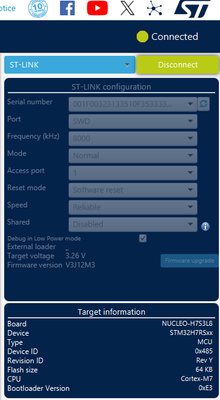

And on the NUCLEO-H7S3L8 (Device ID 0x485) the onboard ST-LINK also connects:

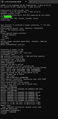

Then, I can change the power supply to leave the ST-LINK unpowered and power on only the H7S3 and connect the J-Link by cable (I double checked the pinout, it's all correct!). The software shows me the same errors as the original post:
Apparently it fails to read the Device ID and looks for Device ID 0xFFF which does not exist. Connecting to Access Port 1 instead returns 0xAAA which also does not exist.
Connecting with J-Link Commander software is fine. Reading DBGMCU_IDCODE (@ 0x5C001000) returns the expected Device ID 0x485.
@baron wrote:
This can happen if the board is not being powered.
In this case, the target does have power:

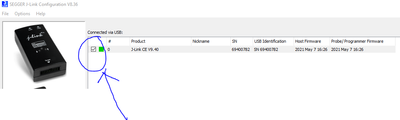

 I just add this tick then it work

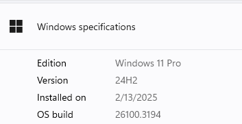

Hello everyone!
I just dropped in, since I had the same problem with J-Link EDU Mini V2.00 and STM32G431 MCU. Updates did not help, and I could connect to the MCU with ST-Link. What solved my connection issue was changing the driver.
For some reason, the J-Link came configured using WinUSB driver. In the J-Link configuration program, I've switched the USB Driver (Windows) to SEGGER, and it instantly worked.
