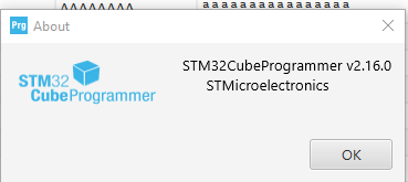

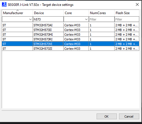

I`ve downloaded and installed the latest application and was told that the CubeProgrammer could support J-Link now.
the GUI shows that JLink device can be selected:
I clicked the connect bottom, the chip select window of JLink was popped out:

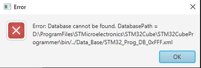

after correct chip was selected, the error window showed below:
the error logs like this:
 15:30:23 : UR connection mode is defined with the HWrst reset mode
 15:30:23 : 20730746
 15:30:23 : Error: J-Link - Connection to target failed
 15:30:23 : Error: J-Link - Reading CPUID failed
 15:30:23 : Voltage : 3.30V
 15:31:20 : Error: Database cannot be found. DatabasePath = D:\ProgramFiles\STMicroelectronics\STM32Cube\STM32CubeProgrammer\bin/../Data_Base/STM32_Prog_DB_0xFFF.xml
 15:31:20 : Error: flash loader cannot be loaded. FlashLoaderPath = D:\ProgramFiles\STMicroelectronics\STM32Cube\STM32CubeProgrammer\bin/FlashLoader/0xFFF.stldr
 I wander if the app support jlink probe, if not, why I can select it?

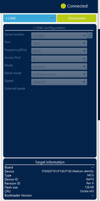

Best answer by AScha.3
I just tried on my Laptop here, no problem :
Its on Win 10 pro, 22H2 .
ed
Just i remember : my J-link refused to connect to new H7 series, needs some update to connect to this.
So try connect with an "old" cpu, like the F103 i tested here, to check: problem with J-link version or other.

Andrew Neil
May 11, 2024
So can the J-Link connect using Segger's utilities?

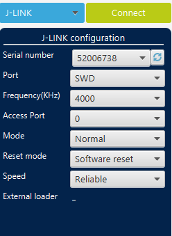

I found out that the correct database for the STM32 that I'm using (STM32L052K8) should be 0x417, not 0xFFF. Why does it want to choose 0xFFF?
You'll find the configuration I use below:

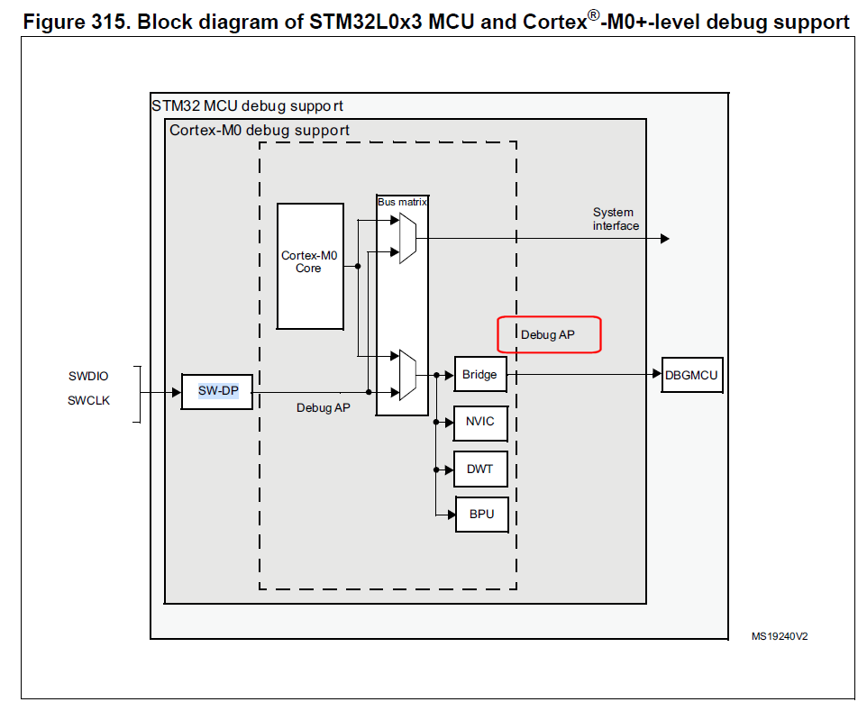

I suppose that "DAP" is "Database Path".
As per the first link you provided, I have checked VTREF. It is 3.3 V.
I have also reduced the speed down to 100 kHz, but I still have the same error.
As per the second link you provided, SWDIO and SWCLK are "used by the debug".
